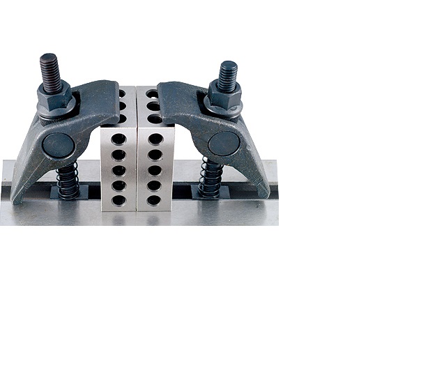

Here are some details and ideas...
I haven't seen one like this before! I don't see any T slot tooling. How do you use it? ( I often used my tables more like sawhorses, for example.) Do you clamp only with F clamps?
Either that or magnates...or tack it to the table...grind off. I made two extra top pieces in case I need to change them out. I have found that the clamps...good ones... hold things just fine...
