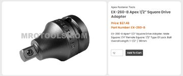

The holy grail of adapter sockets:
Looks like it would be a group buy anyway since they only sell them in 12 at a time?
They probably know you'll need spares :LOL:
They look VERY husky and well made. I thought we were the only ones using black Ball detents....

I went to buy this a few days ago actually - the $25 shipping made me skip it. If I can get one ordered on a truck, I think the square (no steps or transitions) will be the best design for strength.
I'd be very curious what one made from your exotic materials breaks at.
Let's just say it's quite a bit more than any of the adapters lol. Work arounds were found, but I still need some strong adapters for non-destructive work.
