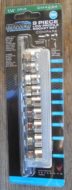

RE: O'Reilly's "Power Torque" brand: gave my buddy a set of their little "low profile" metric sockets and he loves them.
