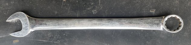

Such an annoying size skip. I like to collect (and use) older combination wrenches. It seems every set skips 1-3/16”. It is a size I actually use. It was common on 30-60 series John Deere row crop tractors (John Deere sells decent wrenches, they do not make a 1-3/16”…..).
So I only have Snap On in 1-3/16”. Did PROTO ever sell an 1-3/16” combination wrench? Any other companies? What brands do you guys have in that size?
