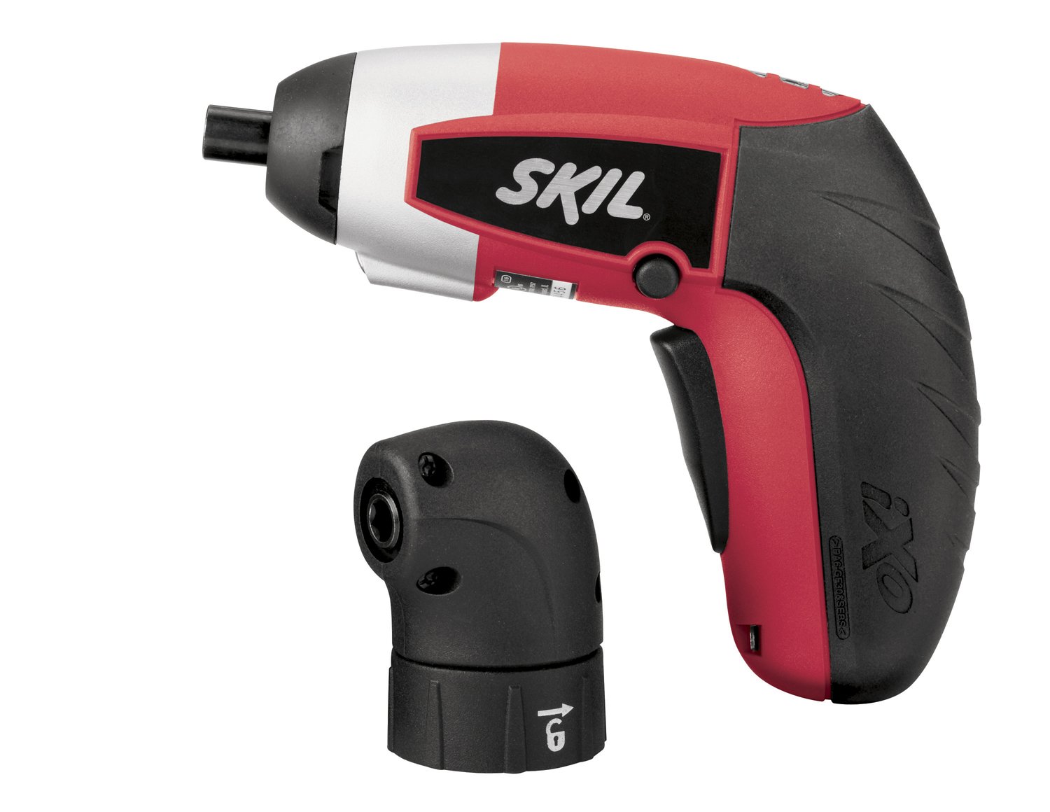

I don't think he's talking about impact drivers. He is probably talking about these:
I haven't honestly found a point to them either. I guess if I was running a bunch of stuff down repeatedly it would come in handy, but a regular drill chuck is just so much more versatile...
