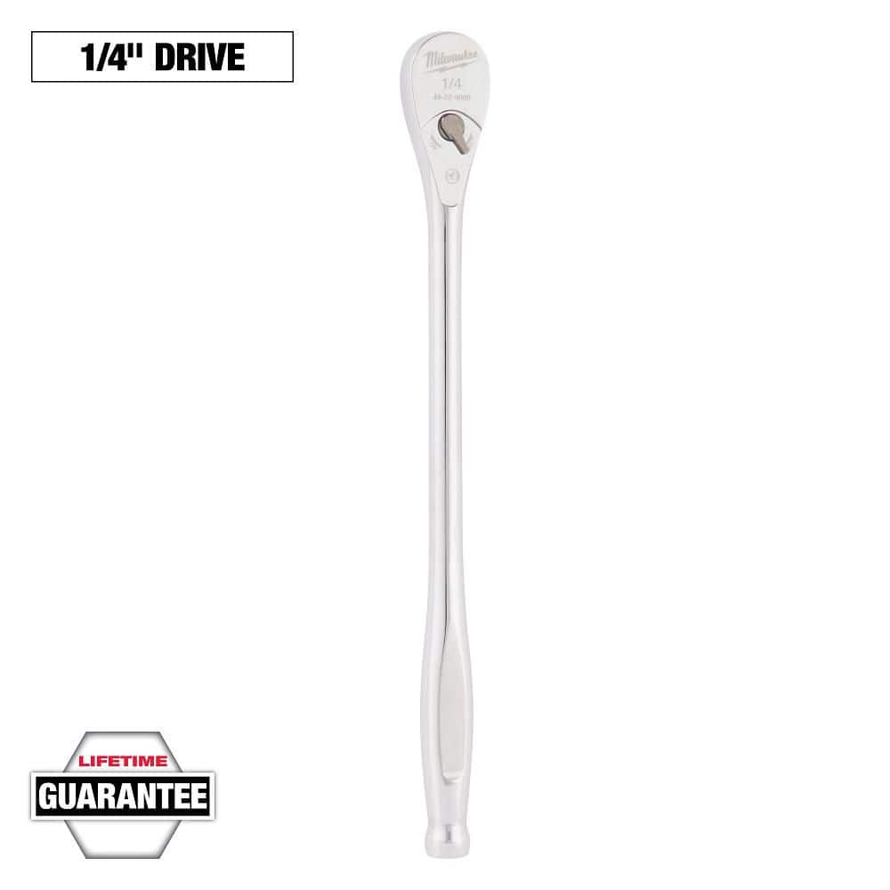

Specifically, I've been looking for a non-quick release, non-flex head, long handle (9-12") ratchet. I was hoping to spend $40 or less, but please feel free to suggest whatever you've found to be good. Thanks.

Titan 11304 is a 12” comfort grip 36t pearhead, non flex, non QR. COO Taiwan. $20.
#11361 is the same ratchet but a slim head version. $25.

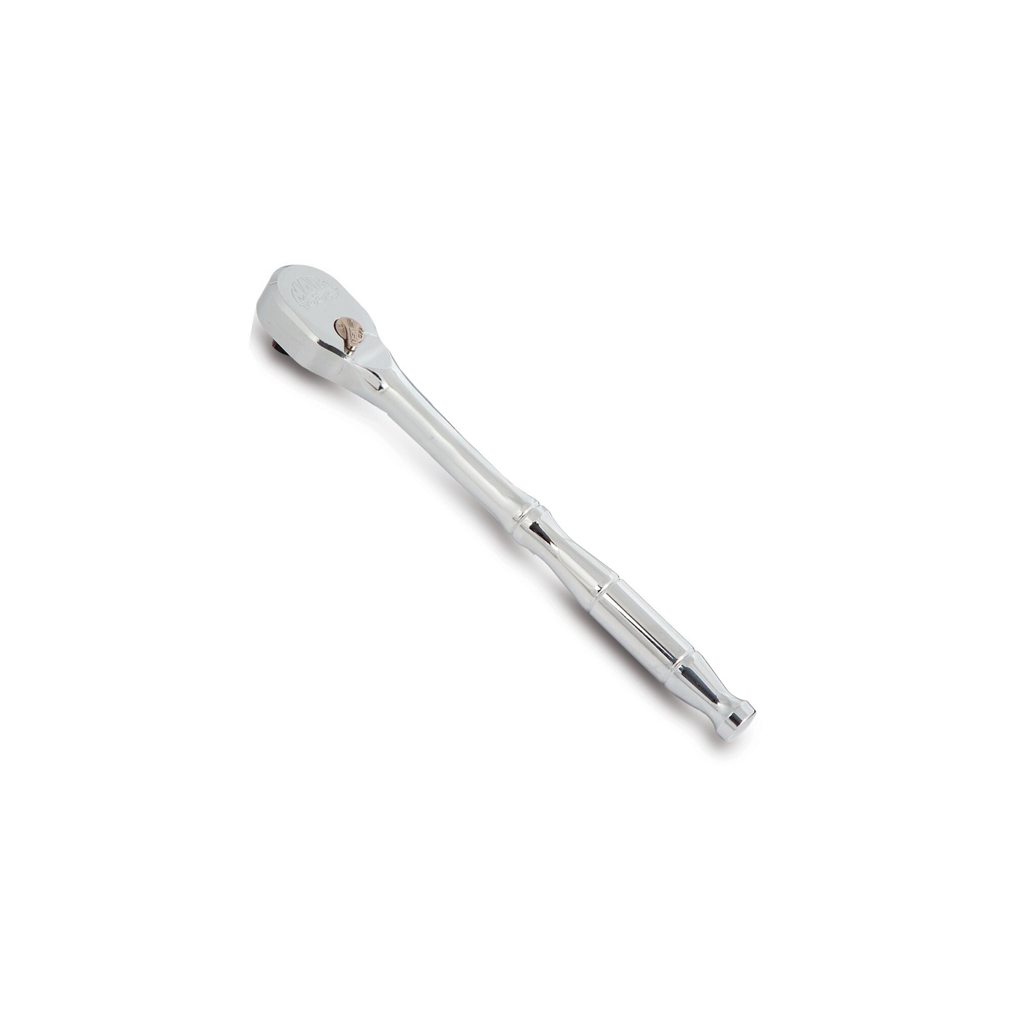

VIM 10"
Ive not used one, but great recommendation! I had forgot about them releasing those.
Pretty good buy @$33 from JDTCo. with free shipping:
https://www.jerseydiscounttoolco.com/product-page/vim-1-4-drive-10-heavy-duty-90t-ratchet
