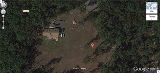

We are concerned with the barn/barns taking over the property. I attached a screen shot of our place so hopefully it works as I've never done that before.
Our other problem is we need a variance for anything over 600sq' which is not a big deal as plenty of property's have barns larger than this and we are on just under 5 acres.
We would also like to have the barn 10 or so feet in front of the front line of our house which is another variance needed.
With the way our has is situated on the property the pole barn will be seen driving down the road and the first thing you would see as you hit our place. We are at the end of a circle/cul desac. We will be planting trees etc to soften the look. The previous owners cleared the property and in the last 2 years I have planted around 180 trees.
It would be placed to the right of the house and slightly forward. We dont want it behind the house as it would ruin our view of the woods and also the cost of paving/services back there would be huge. It would also mean a driveway cutting through our yard.
The land to the rear and bottom left of the screenshot slopes away quite a lot and the foundation build up would be expensive, and also the cost of a driveway etc back there.

It's just where the building would be situated. Did you see the attached google maps screen shot? It would be straight out from the end of the road/circle and main thing you see as you come into the property.
We are going to be adding some large trees in front of it though to soften the look.
