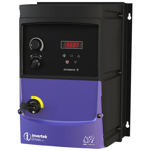

u3b3rg33k
Dec 18, 2017
4,079
I like the invertek IP66 drives. no enclosure needed (just wire your whips to the built-in junction box), and glove friendly controls on the front:
1P 110-220 3P model https://www.driveswarehouse.com/ode-3-210058-104b
1P 220-220 3P model: https://www.driveswarehouse.com/ode-3-120043-1f1b
