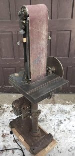

Looking for a pedestal stand for my craftsman 103.0803 belt and disc sander and I think I’ve found one but it’s 3 hours away and I’m not for sure if it’s the right base. I have some pictures if anyone could help me Id if this is the correct base.

Cruzan80
Jul 22, 2015
4,327
Denver, CO
The .0803 was only available with a pedestal stand for one year, and then they changed it over to a different design. Be aware there is both a 4" and 6" belt sander size that had pedestals.
CKS1955
Oct 12, 2014
490
Here’s pictures of the stand you need (it’s the only one I’ve seen in the last 16 years). I have different opinion than what was stated above, I find the stands to be stable and like the look.
As FrankLee mentioned, those pictures you posted of the pedestal stand are for the Craftsman 12” band saw.
As Cruzan80 mentioned the top mounting bracket that attaches to sander was only offered the first year that pedestal stands were available 1954/1955. They redesigned the sander the following year and modified the top mounting bracket in 1956. The rest of the pedestal was the same (Base, Post, Motor Mount).
