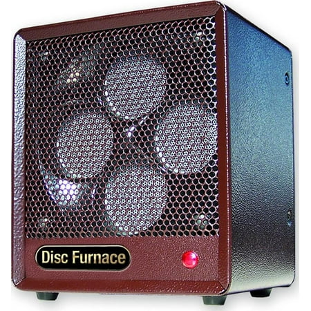

Is it attached to the house, could open door and run a fan to get it started and add a 1500 watt ceramic heater or a radiant type near where you are working will make you feel warmer.
if find this type provide the most air heating potential.
I find this type makes me feel the warmest but dosnt warm the air as quickly.
