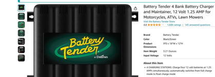

I've got about a million battery chargers and maintainers. You want one that will do a reasonable float voltage. Really, not much difference between them (minus the HF variety where the wire insulation literally was falling off after 2 years) at least in ones that I've owned.
Most recent "tender" I bought it immediately below, I chose it because I need to LiFe04 batteries in addition to lead acid.
Others I own that have held up for 5-8 years:
