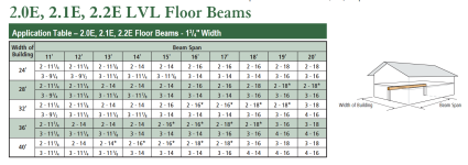

I used beam and joist span charts from the American Wood Council for a deck (40PSF live, 10PSF dead... Admittedly that's probably a little light) and they showed that I'd need 4 posts unless i went with a triple 2x12. LVL wasn't a huge premium and working with straight, dimensionally accurate material that didn't require a splice is always nice
we could do LVL for the stringers, in which case, I'd probably drop one.
i'd be interested in the truss idea, but I don't know how to design for that.

How big would the lvl's need to be to avoid the middle posts? The table I posted above seemed to indicate a double 18 or triple 16. That's a lot
Good point on insetting the posts... Something to consider. Any guidance on how much of a cantilever is acceptable? 1/4 the span?
If that cantilever is reasonable, I could maybe do the front, 20', side with a triple 11", 14' span with 3' overhang on each.
The back side is 23', so I'd probably just keep that to 3 posts, plus they won't be in the way
Simple beam theory is 1/3 each end. So for 20 feet, 4 feet each end, 12 feet span in center. That's for bending. I'd have to pull out my grad school engineering texts to check vertical shear, but I guess the lvl company will do that if you give them a simple diagram. (I don't think lvls were common when I was in grad school so would have to check. And if I were doing this today, here, pretty sure an 8 x 12 would do it - rough sawn from Amish.
In theory your center posts carry 1/4 the load, and corners 1/8. With just 4 they all carry 1/4.
You couldn't live with a deeper beam on long edges? I think you'd still have 6'-8" clear, code minimum head clearance for a beam or duct or door.
Thanks Bill.
6'8" would be barely enough in my shop, although my buddy is shorter. I'll run the suggestion by him

this is with a 2x14" LVLs both front and back. span is 14'10" and the cantilever is 48". to widen the span, i think i will need to move up to 16" lvl, which will make the headroom too low.
i could move the posts by the staircase in by a foot, but then the bracing will get in the way
