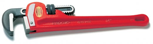

Since you've got it soaking now, when you take it out be sure to neutralize it in a baking soda solution right away, then wash and dry. To make it look like this pic from the Ridgid site...
... you could black oxide or blue the dynamic jaw and nut; paint the handle red; and grind/sand off the machined and toothed surfaces.
