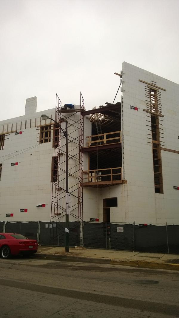

So now that I have the garage built, thinking about buys a used scissor lift but those things are pricey around here...I was thinking about getting an 18' scaffolding. I've been up on a 12' one before and it was fine.
My building is 20' at the eves so it should be just the right height for the center areas to put up lighting and electrical.
Anyone have any thoughts/concerns about 18' scaffolding for doing this type of work?

My boy has been working daily on a 5 story scaffold for 4 years.
Union, professional assembled,, downtown Chicago, but he trusts it.
It is 3 blocks from the lakefront, so he watches the wind forecasts.

Thanks for all the replies and scary thoughts! Going up 18' does seem a little sketchy. My next post would probably be "FS: 18' Scaffolding, barley used"
My problem with renting something like a lift is it's going to take me a year to get what I want done in the shop. I'm not an electrician so even getting my buddies who are to come over and help me out is going to take some time. I figure if I buy a used scissor lift I can probably turn around and sell it a year or two later for a reasonable price and get most of my money back. Scaffolding I'd probably loose half the cost but it's only $500 bucks.
