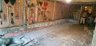

I have been wanting to pour a threshold under the overhead door in this section, mostly to keep the groundhogs from coming in and trying to burrow under my main concrete floor.
The opportunity presented itself recently.
Empty room, jackhammer out old concrete livestock waterer base, mark for concrete depth and compact 411 floor.
First couple wheelbarrow loads. Truck chute could have reached the back, but my guys are so good that they prefer to use wheelbarrows. Their reason is it is not as sloppy and they can place it more accurately with less water.
Halfway there from the other end of the room.
I love my dog, God bless her simple soul. Son came out later in the evening to use the drill and dog came with him. He never even thought of the concrete, and the dog had been curious all day, though confined to prevent incidents. Oh well, they are light depressions, not nearly as deep as they look in this picture.
And time to fill it back up.
Guess that ended up as more than a simple threshhold. Ah well, a little overkill never hurt anything.
