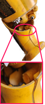

18V DeWalt Sawzall busted shell
penright
Dec 27, 2016
618
SW of Mustang, OK
I have tried searching for the shell online. Most parts website have them "Discontinued". When I find something on Amazon, it 20V. Also the parts talked about V1, V2, etc. But I could not tell the differance by the pictures. I can try glue, but I don't have too much hope in that.
Any thoughts, other than by new. :) I have a huge colection of 18V tools.
Just about the only plastic that doesn’t glue well is polyethylene. And I guarantee that isn’t polyethylene.
Take it apart. Clean it up with isopropyl alcohol (or simply soap and water). Slather the joint in epoxy. Screw it back together and clamp it overnight.
Or the hack-y way to do it would be to wash it down, then clamp it, then just absolutely flood the outside with glue so it has a sort of band-aid over top of the split.

Perhaps a bit less glue but use a couple of long 10-32 screws right through where the old attachment was, the main body looks intact.
I'd not be spending much $ on this. The minute you get spendy it will die.
Good idea. Sometimes it is as much the challenge as it is the money. Don't get me wrong, I love saving money also. :) One reason I enjoy Vintage Machinery, Cutting Edge Engineering, etc YouTube videos is when they fix something. Keith brazes a tooth back on a gear and machines it back. Or Kurtis welding up and then align boring. Will take a look at your suggested fix and report back.

Maybe "screw it and glue it" with some metal tie straps to bridge the housing pieces and epoxy as suggested above. Or for a nuclear level fix wrap it fiberglas cloth and resin in addition. Or just the easier way out with a used housing. Doesn't Dewalt offer adapters to adapt older style batteries if you buy a new one that takes the new style batteries.

Glue it or figure out a way to use a screw. I wouldn't spend $10 fixing an antique reciprocating saw like that. It would be easy, or not at all (but I would actually try to fix it if it was working and I had a use for it).
