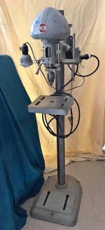

I tend to agree with you as to spending $175 for bearings for a DP that rarely sells for more than $150 in excellent condition. I would sell it as is and look for something with a wider speed range (as in SLOWER speeds) and longer spindle.
You didn't show a pic, so I'll add one from a local seller. He's asking $150 and it looks pretty good. It even has the coveted "retirement lamp".
