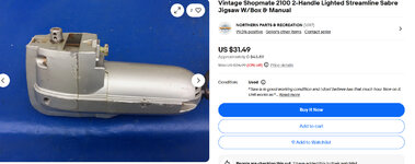

I think this is missing some kind of collar that had another screw in it. The shiny part of the rod tells me something like that was there AND I saw pictures of the same model with something on it.
I think the yahoo who owned this lost that collar, and had trouble getting the blade to stay put without it, and kept tightening the screw until it broke off. Than at the scrap yard the goons there cut the copper wire off, threw it down on the ground and snapped the blade off.
I'm wondering if a solution is to drill out the stump of the screw, drill out the messed up threads, than tap it for a new screw.
But I don't have a tap set or a v-block for my drill press.
