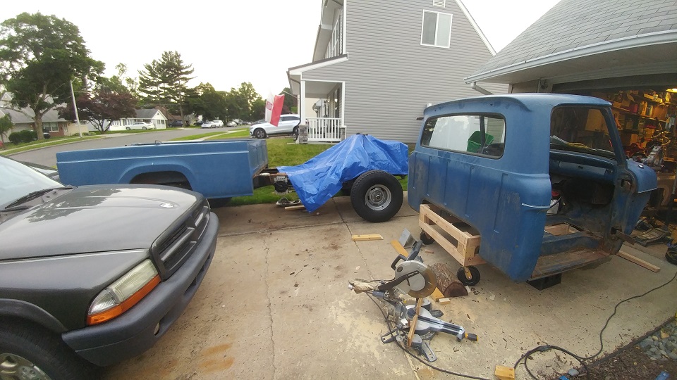

Slowly marching on to July of 2018:
Getting the cab off and onto the dolly was... interesting. Couldn't grab anything down low because it was all rotted, had to clear the larger tires and the 460 put the top way out of easy reach.

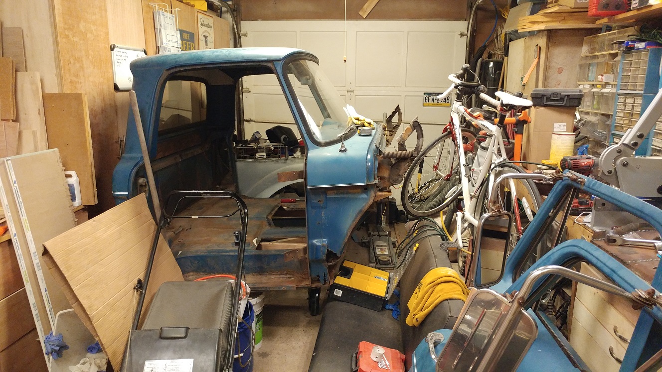

I've shared this before, this is my work space... At least it's something. My dad allowed me to store the doors and seat in his shed so I had a little more room. Just enough room left for me to rotate the cab on its axis.
Lets get started with the archeological work!

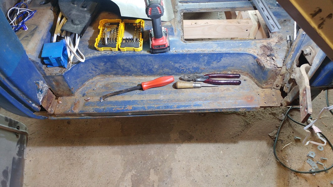

This is where I'm starting to really question how far over my head I am. Actually got a bit depressed about the whole project. I don't have any sheet metal or body work experience. I started looking for a used cab, but anything I found was just as bad. Plus I already had about $750 worth of replacement metal...
The step riser was scabbed over the existing rotted out originals, and the treads were replaced. Rockers never reinstalled, just some C channel. Everything was held together with aluminum rivets and rust.

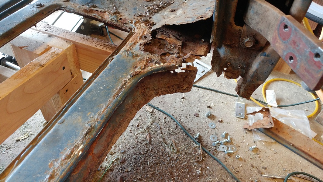

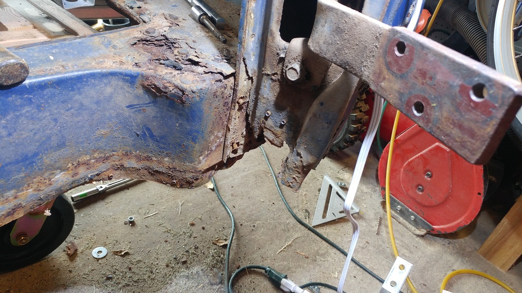

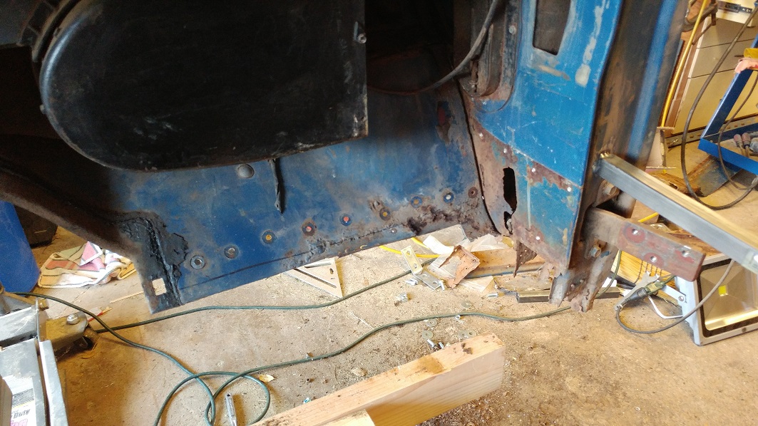

Passenger Cab corner. This is where I started after I ripped a step off. At some point the outer cab corners were poorly replaced, and inners left alone.

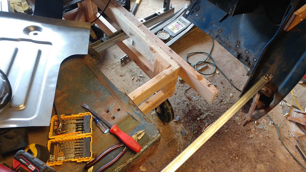

The first official fix. I had to take a break from cutting stuff out. I had to add something instead of removing... Rear sill corner (correct name??) is still there for reference. I eventually contacted flashbackf100s to be cut out of a cab, as they were way beyond my skill level. Multiple compound bends. I did try though, and came fairly close but it would have bothered me if I installed as is.
Another view. Cab is supported from the front too, not just that piece of tube. I did eventually brace more, but none of the measurements I took changed. My only real complaint with the project, once I buckled down and stopped my whining, is that I didn't have a good side to get references on. Both are equally shot.

Big jump - COVID quarantine allowed me to get most of the metal work done. on both sides. It took me about 1.5 years to go from cutting out metal to having the step installed on the passenger side. It took 3 months for me to finish the passenger side and driver side, cab mounts, and finish the underside.
I did really take my time on the passenger side dismantling it because I had to learn how to be able to put it back together.
Can't find the passenger side, so here's what I did on the drivers side. Similar process.
Thankfully CarolinaClassics started repopping these panels. I really wasn't looking forward to making them.

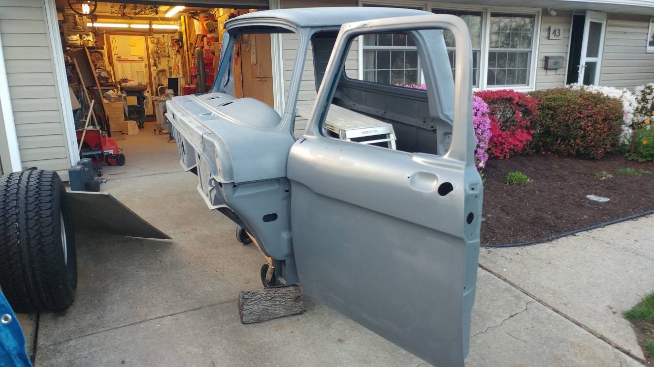

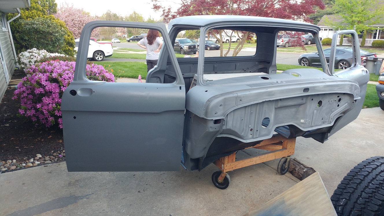

Quick view from the drivers side, getting closer...
Her first time in the truck since she was about 4 months old. She's 4 here.
After decided to remove the old CB antenna. After I epoxy primered the whole cab I decided to weld in the back seam over the window...
Bought a cheapie paint gun and my first attempt with HVLP paint and epoxy primer.
Testing my lifting jig. 1.5" Angle, flat stock and leftover tube.

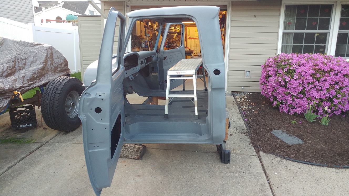

Sitting the cab on the frame for the first time in over 2 years. I needed to do this so that I could position the cab mounts and tack them in.
Yeah, that was interesting. I was able to do it with the engine hoist, ratchet straps, and a 4x4. My wife was also a huge help.
You can see how much metal I had to replace in this picture.
That factory undercoating held on pretty well. Went through two wire wheels.
Mostly clean. I think I went through two more cans of cleaner after this.
Seam sealer and epoxy primer.

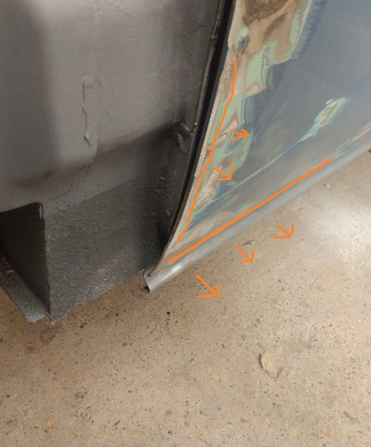

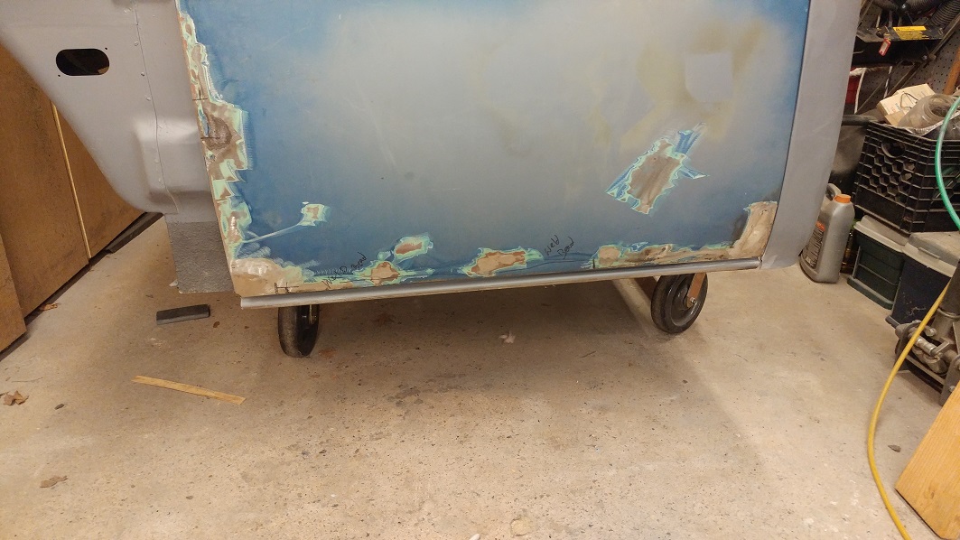

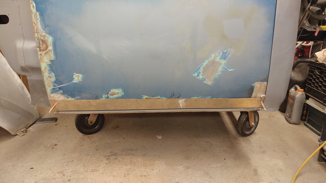

This brings me to my current issue. I'm doing fit up on my drivers side door prepping for bodywork, and I cannot for the life of me get bottom left (hinge side) to come out any further. It seems like it needs to come out about another 3/8 to 1/2 inch. The rest of the door seems to be okay, as the problem is the worst at the bottom left and gets better in each direction. I'm fairly confidant my layout was correct, and I did not cut out the top bottom hinge bolt so I still had some sort of reference. My bottom hinge is maxed out all the way to the left (out), and I still can't get the door bottom out far enough. There isn't any sign of accident damage to the door, other than rust. Am I missing a way to shim this some how inside the door?
Door is flat with a straight edge. I've temporarily hung a fender on it to show how far in it really is. You can really see how far out it is here. Bottom of fender is aligned with the rocker panel at the bottom. This is probably the best picture I can get because of space limitations in my single car garage:

Probably a lot more qualified people than me, but a few ideas anyway. Did you replace the section of the "A" pillar that the lower hinge mounts to? Repop parts aren't always exact replacements, hinge might not be in original location if so. I'm stumbling through a '59 Ranchero and new hinge pins are recommenced when doing doors so there's that possibility though you'd probably have noticed excessive movement there. Does the door fit flush on the interior at that corner? Everything else looks great so far.

One more thought. Might be an optical illusion, but from that last pic it almost looks like the fender is the offending part, not the door. Can that bottom corner move inward any? I could be way off base though. Good luck!

I bought a CarolinaClassics repop, which seems pretty high quality. I only cut off halfway through the lower hinge mount, leaving me the top and middle two bolt holes for alignment. I'm pretty sure my layout is correct.
John
The bottom of the fender is tight to the body, and is almost perfectly in line with the rocker panel. It's really weird, going north along the fender/door line it gets better the further up you go until it's perfect. Same thing going east, until it gets better until it's perfect where the rocker/cab corner meet up.
I feel like if the bottom of my lower hinge mount was installed the extra half inch out of alignment needed to correct this it would be obviously installed wrong. I need to take some measurements and compare this door to the passenger door.

Just went out and looked again. I'm somewhat worried that I installed the rocker panels backwards, since they're tapered. But from what I remember they only fit one way, and barely.
Has anyone here installed these before? I put them in fat end towards the front of the truck.

I think I figured out my door problem. I had read that it didn't matter which way the hinges went, but apparently they do. I flip flopped them and got a much better result, but now I have to play the adjustment game again.

To me it looks like the fender is off. There are ways to massage that and make it better.
I think you're right. When I built the lower cab corner I assumed they were at a 90 degree angle, but looking at pictures they are at a slight angle in towards the center of the cab. I think I'm going to make my changes to the fender structural support, because I don't need much and it'll be a hell of a lot less damaging to my undercoat.
A good rule of thumb when lining things up are steal a little here, steal a little there rather than try to make it all work in one shot. In other words, move the door a little, move the fender a little etc. This type of work takes a lot of experience and man hours. Just keep fuc*ing with it and you'll get it.
Thanks for the advice, that's what I ended up doing, and here's where I'm at so far:
Going to build up the bottom edge from left to right about 5/8 to 3/4 of the way with some weld, and then I think I'll be happy. Part of me wants to weld a strip on to the bottom all the way to have a tighter gap but if I start heading in that direction I'll never have this thing on the road again.

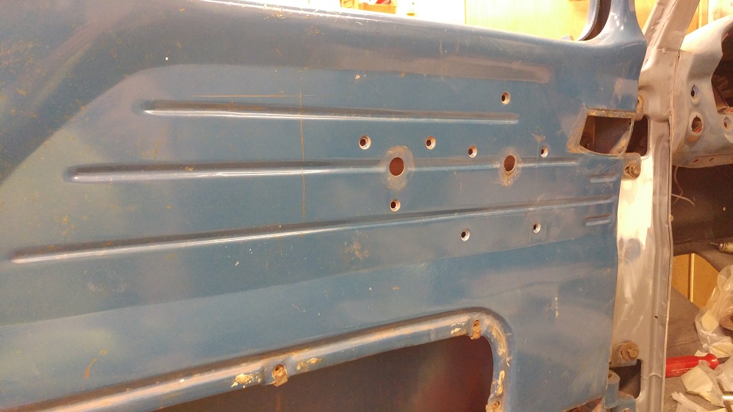

Can anyone ID the year of this door? I believe it's from a 65/66. The only thing that doesn't make sense is that it doesn't have any holes for the door card, and they weren't filled in.

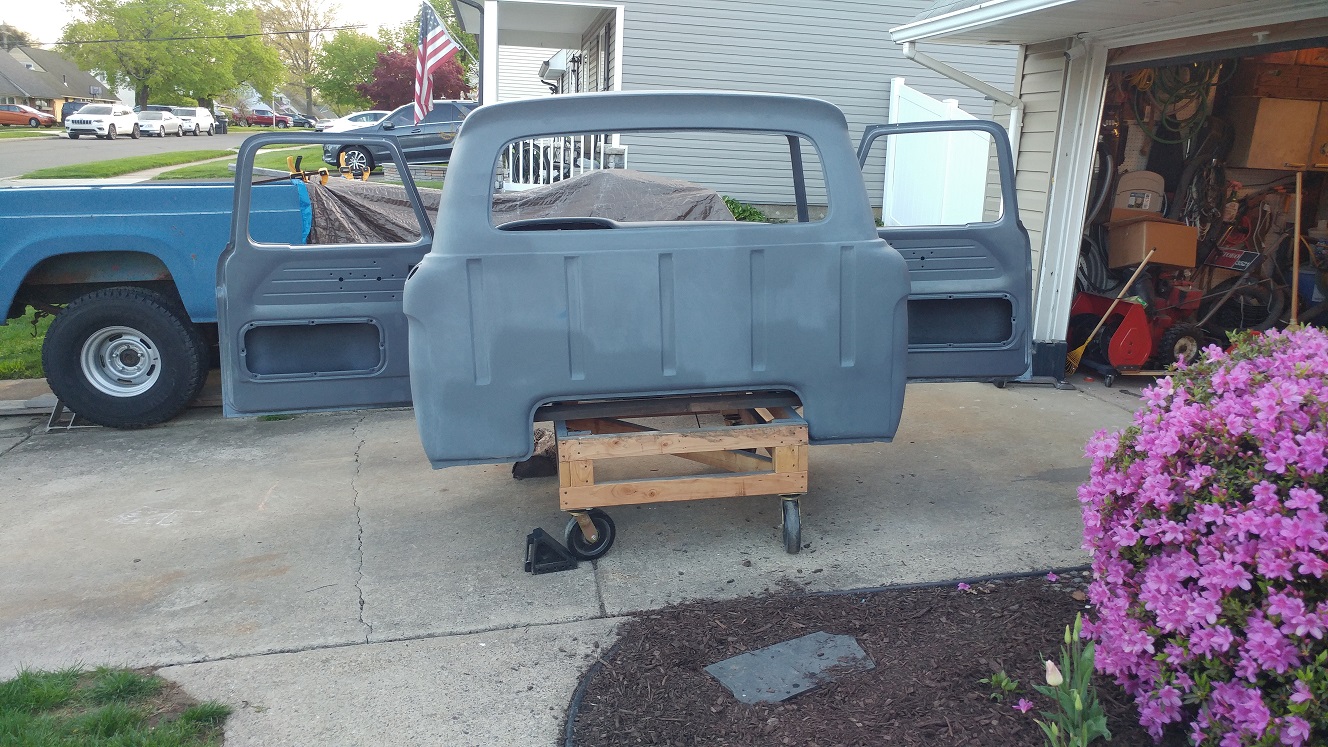

First coat of epoxy primer:

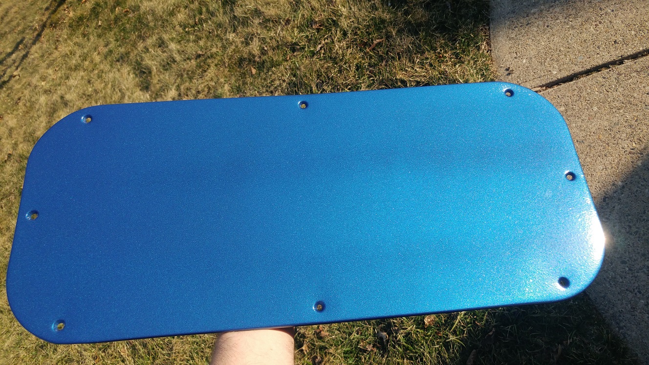

Some time before the above pictures I got impatient and had to spray some of the color I chose for the truck. I took one of the door panels and did a half-*** epoxy/high build/color test and got this:
Awful overlap, mediocre surface prep, slight orange peal, but no drips/runs.
I upgraded from my Harbor Freight gun to the Eastwood Concours 2. What a world of difference. The HF gun sprayed the epoxy primer fine, but I just could not get high build primer to lay.
That test panel was done completely with the HF gun, so hopefully it goes down better with a slightly higher quality gun. My cleaning methods have definitely improved too.

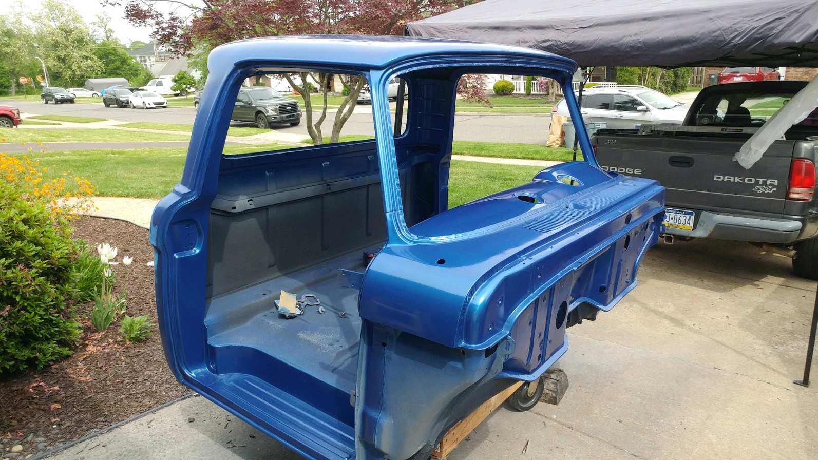

Another small update:

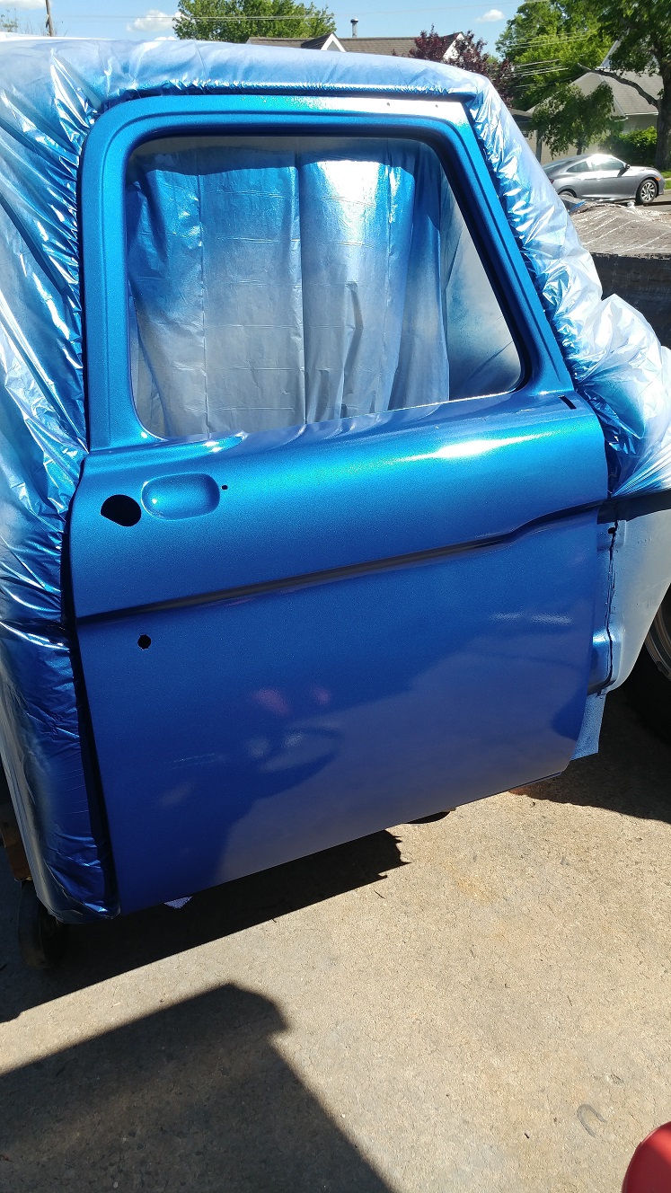

Did another test shoot, this time on the full outer door, and the results are mixed...
I'm thrilled with the color and flake distribution. It looks amazing in sunlight. The orange peel is pretty bad however. First coat went down extremely smooth, looked great other than coverage. Then with the second coat I believe I tweaked the air pressure and I shot it a bit too far away. I corrected those mistakes on the third coat but it was already a lost cause.
My plan is to let the paint harden then sand it down and try again. I plan on narrowing my fan a little and going a bit closer with the gun and seeing if that helps. Maybe I'll use the flats on the back of the cab to test. They'll be a bit easier to sand down.

Back again!
"Let me just paint the dash" turned into "Lets paint everything Sunday".
So how did everything turn out? This time time I got a glass like finish over most of the truck. I painted the back Friday, and it turned out better but not as nice as I would like. I've learned that there's a very fine line between putting enough paint on to flow out, and too much where your flake starts moving in a less desirable pattern and runs.
On the back of the truck I did what I mentioned before, closed down the fan a bit moved closer. That netted me quite a few runs in the paint and poor flake flow. On the rest of the truck I opened the fan all the way up and stuck with the same closeness. That seemed to do the trick.

    • Apply door gaskets.
      That's about all I can do ahead of time because I need to limit the weight to get this thing back on the frame.
      Then, on the big day:
    • Set the cab and bolt it down
    • Front and rear windows put back in
    • Hang doors
    • Enjoy?
My schedule:
The next two weekends are a no-go for me. My daughters 5th birthday party this upcoming weekend, and next weekend to the following weekend is our vacation. So everything I will be doing will have to be able to be accomplished after work. I plain on finishing the cab painting on Tuesday, since I have off.
After the cab is on I think I'm going to be taking some time off of bodywork and painting. I think I'm going to be rewiring the truck up and getting it running again because its been too long since I've heard it.
That's it for now.
Oh yeah, I am glad that I put up that shade canopy and put up some plastic on either side. Waaaaaaaaaay more over spray than what I saw with either primers.
-yet another edit-
I'm happy with about 98% of the body work that I did. There's a few dings that I missed, but I've decided to let them go because this isn't a show truck, and it's going to be used and abused.
Also, a question:
For those that have restored vehicles with cowls and cowl drains, what have you done to protect it? I realize that it's fairly late into the process, but all I have done so far is spray primer in there. Strangely enough, the cowl was the most solid part of the lower truck. I'm thinking about masking off the cowl and pouring some POR15 in there, and letting it run down and out through the drains in the front cab that I replaced.
Thoughts?
Benw455
Dec 20, 2005
752
WV
Fantastic job. I need to quit complaining about space after seeing what you have done in your garage.

Not sure about cowl or rust prevention, but paint looks great!
Thanks! For my first time, it didn't turn out too bad for a driveway paint job. I definitely shouldn't have went with a metallic for my first time though.

Further adventures in DIY auto painting...
I'm finally getting better at spraying this single stage metallic. I've been working on the hood, and it's taken quite a bit of work. No metal replacement was needed, but there was quite a bit of small dents and a very large crease in the center rib, about an inch deep. I was able to fix that as well as some really bad oil canning (by stretching instead of shrinking. Completely opposite of what I thought).
I epoxy primed, filler primed, and then painted the hood. I had to stop after the first coat because of some type of oil contamination on the hood. I'm pretty sure that I was plugged into the wrong port on my compressor, after my water traps and before my oil condenser and desiccant dryer. I also had horrific tiger stripes, and some pretty bad scratches, so I started over again.
I watched a few Youtube videos (cliche, I know) and figured out my problem with the stripes was that I wasn't getting enough paint volume coming out of my gun, and I was holding the gun too close and moving too slow to compensate. I had a 1.3mm tip @ 28 PSI (paint calls for 1.2-1.4mm @ 8-10 PSI) and with the gun fully open I wasn't getting enough flow. I changed out to a 1.7mm and kept the pressure the same and everything was perfect. I'm starting to get the hang of it, and a big part of it is realizing that I do have time to make corrections. I am unsure though why I need to jack up the pressure so much though. At 10 PSI I wasn't getting anything out.
I think the only thing now is for me to get a bit of a slower activator for the temperatures here. The paint set up a bit fast on my second coat making my touch ups a bit tough.

Painting can be such a *****. It's such a feel thing and if you don't do it all the time with the same materials it's tough to get a good result. Temp has a big effect too. I've usually been able to fix a not great clear coat with a color sand and buff but if the metallic isn't sprayed super even it will show forever. The Camaro in my avatar was my best paint job result.
