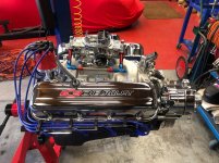

Did I bother to show you folks what got dropped off last week?

Awesome build! Your fabrication is gorgeous and that exhaust is a work of art. Who does your engines for you? May I ask why you didn't opt for a LSA? Besides the fact that I'm partial to them, they are a great package combined with the 6LE

You can't just show us a big block without specs - tell us what is inside and show us the numbers on the transmission killer! :evil:
There is just something **** about looking under the hood and seeing a Big Block Chevy staring back at you. :rocker:
Can't wait to see more. :thumbup:
Pretty standard fare really. High nickle Bowtie Iron block with 4 bolt mains and one piece seals. 454 C.I.
Steel GM performance Crank with forged H beam rods. Forged pistons with some dome work.
Roller Cam, with 1.65 Billet Aluminum roller rockers, all studs are screw in of course.
Motor built to exceed 7,000 RPM
It is knocking on 600 HP with a 6000 RPM button in the MSD. Expect low 700 HP with no power adders.
Let me see an LS do that:shocking:
