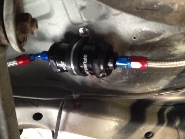

First task, mounting the Fuel Lab inline filter, and -6AN feed and return lines. Using self tapping screws & adel clamps I ran the feed down the driver side and the return down the passenger side. We decided to run return on the passenger side because there really isn't a great place to mount the AFPR on the driver side, and to avoid having to run a return from the AFPR mounted on the passenger side, all the way back to the driver side.
The inline filter is mounted near the driver side rear wheel well.
