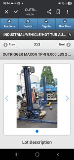

I have a old Maxon outrigger 2 post lift. It is similar to the picture attached. Mine is older and yellow at least 40 years old. It came with as new set of all the the bronze bushing wear parts.
Im looking or an assembly / user manual. Either hard copy or electronic copy would be great
Thanks on advance for your help.
