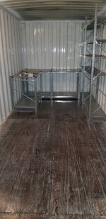

Hi everyone,
I am in the process of transferring my hobby workshop in a 20ft container.
Bought a used container, transferred it to my garden, cleaned derusted and painted inside and outside.
I kept the original wooden floor of the container and sealed it with polyurethane varnish.
For storage purposes I installed metal shelves in one corner and built a 180cm x 180cm corner workbench.
It is taking some time to come together as i work in merchant ships and i am frequently away from home.
I still need to finish the workbench, install all the electrical wiring, sockets etc.
I want to build an overhead crane inside the workshop to be able to lift and move heavy parts and jet skis. I already have a 250 kg electric hoist, top weight I am expecting to be lifted is on the 150 mg area. Any ideas?

The container is sitting on a concrete slab, so there is no moisture trapped on the underside.
When I painted the outer shell I thoroughly derusted all the box, applied 2 coats of primer and 1 coat of paint on the sides( two coats on the roof).
I am planning to apply a final coat of paint outside after all the work on the shell is finished, as there will be some burns on the paint from welding.
The inside of the box did not have any serious rust. I used a 200 bar water blaster and cleaned all the inside and the floor. Any area which was slightly rusted was cleaned very good with the blaster. (We use the same practice onboard ships, but with a 500 bar blaster).
After good drying time, 1 coat of primer and 2 coats of paint.
The floor was sanded, cleaned and sealed afterwards with marine grade polyurethane varnish.

I only sanded areas where the original paint was gone, not all the box. But cleaned and degreased it all before painting.
