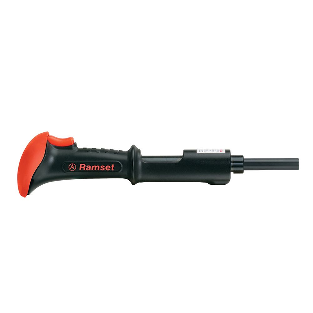

I used to have a Remington you hit with a hammer. Never again will I have one like that. I bought one of these a few years ago. Just used it yesterday and today to set some walls in a basement. Worked like a champ.
$50 at HD. Comfy, easy and reliable...But mostly, predictable.
