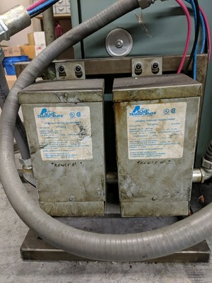

LOL...yeah...there is some conflicting wiring on the transformer but I think if we are using the diagram that I supplied from the manufacture of the my transformer I think it's hooked up right.
So...the wire in the power cable is 8 gauge, the plug says 6-8 gauge for 50 amps...so I wired it up but not to the kiln just yet.
I checked the voltage on my panel, I put the multimeter to the ACV 600 setting and then touched each probe to each side of the panel where the breakers go and I get 252 to about 260. It fluctuates back and forth.
Now on my transformer and plug wiring, before I plug it in and check the power, I put my meter on continuity check and ground to ground went to zero and ground to black and red did nothing. Then red to black goes to zero...is that right? From the wiring diagram I guess it kind of makes sense but not sure if it's supposed to do that...like maybe something is crossed.

wow thats pretty high for nominal 240v service. typically a 5% variance in either direction is the standard most PoCos use, so 228v to 252. I would call your PoCo and ask them to check that out...bucking 260v will get you about 228v so its a bit high for something rated 208v
and forth.
no thats not right. you shouldnt have a dead short between the 2 ends of a coil.

It looks to me like your diagram and wiring is wrong.
See this diagram note there is a 50% chance my diagram will boost instead of bucking. In other words, there is a 50% chance you will input 240 volts and have an output 272 volts as opposed to the 208 you are looking for. You want to test the transformer with the kiln disconnected to avoid the possibility of damage to the kiln. If you measure more voltage than you expected reverse the wires on X1 and X4.
Walta
his diagram is correct. he needs diagram I as ive previously explained.

not sure which chart youre looking at but its incorrect for bucking 240 down to 208.
according to page 10, he needs to use figure I for bucking, which is found on page 17
So L1 goes to H4 and L2 goes to X1
Then connect H3 to H2 and X3 to X2
His load wires go to H4 and H1/X4
So I noticed on my multimeter that just turning it to the 600 setting without anything touching it's reading 22-23. When I move the dial around there is always some numbers already there. I found a cheap Harbor Freight Cen-Tech multimeter and the dial is zero. Put that up to the panel and it reads 238-239.
OK...so I believe based on my drawing below and the previous pictures of the actual wires and wire nuts I put on, that this picture is correct per the wiring diagram and wyliesdiesels comments. The pointy ends of the wires have the wire nuts on them.
My logic tells me that;
  • L1 goes through H4 all the way to H1
  • L2 goes through X1 all the way to X4
  • If H1 and X4 are wire nutted together, wouldn't that mean that L1 and L2 get connected (dead shorted)?
Perfect
I think this is likely a good reading. I would expect something like more than 6 ohm and less than 25 ohms but given the quality of the meters you are using they may not be accurate so close to zero.
As much as I hate to say it the free harbor freight meter may be the better of the two meters.
Safety note before you plug in the transformer turn off the breaker then plug in the transformer. Turn on the breaker while wearing a leather glove and standing to the side of the panel and looking away from the panel and transfomer when you turn it on for the first time with the kiln disconnected.
I would expect to hear some humming from the transformer them measure the voltage that will go to the kiln.

Great news. Plugged in the transformer and read the voltage at 210. No hum from the transformer but obviously doing it's job. Tonight I'll work on the kiln hookup wiring.

Houston...the Eagle has landed! Success!
I wired up the kiln to the transformer and plugged it into my existing 40 amp circuit to test and the kiln control panel powered on. I then just did a quick cycle to make sure the heating elements were turning on and they did! I didn't want to run it too long for fear of my existing 40 amp wires not being enough. So this weekend I'll either replace that wiring or just run a second plug. The real test is ramping it up to temperature so hopefully that will all go well.
