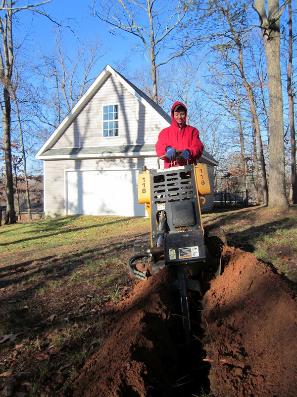

I decided one day this winter that it was time to get the extension cord out of the dang yard, and trench conduit out to the garage. I dug ~3ft by hand (high-mineral content clay) threw down the shovel, and headed to my local rental store. 45 minutes later, I'm in the back yard driving this fun little machine around.
...now don't get me wrong, she's a helluva helper, but usually motorized equipment lands on my plate. This was different, she comes out of the door bundled up and says "that looks like fun, can I try it?".
...she took the reins and I didn't get it offered back it until she had trenched the whole way to the garage.
Power is a simple branch (220v) off the main panel running 12ga solid THWN to a disconnect, then in to the garage. As it is only storage, I have kept the design simple with a single outlet at the front corner, one outlet at the garage door opener, and one outlet upstairs. (Any more would have required an entire panel and all the permitting that involves, which was my aim to avoid.)

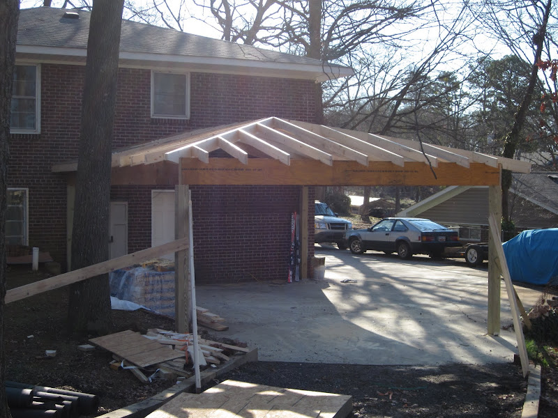

Power was run, car-port was completed, and then a bunch of **** went in there, effectively stopping any further construction (keeping cardboard under the cars to avoid getting oil spots, but still would like to do a floor coating at some point...
...here is another angle from when the carport was under construction, showing the nearly 8ft height to the bottom of the beams. No lifted trucks or ladder-racks, but the vehicles shown fit fine...

Kevin54
MEMBER EMERITUS
Jan 12, 2005
29,341
Urbana, Ohio
Looks great!!!! Any in between pics from when it was started until now? I mean other than the last pic of the framing?
Out of curiosity, how did you flash your roof? Did you make one cut down through, or did you notch the mortar joints?
It looks like you covered the brick wall inside. Is it covered?

what is the floor to peak measurement? I'm basiclly building this same garage. Thanks
