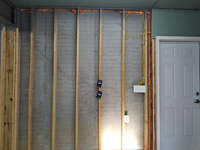

Then I tacked the electrical. In Howard County Maryland, you can pull your own electrical permit for 15A and 20A branch circuits. I had to show the lead inspector my electrical plan and pass a 1 hour open book test. It was around 35 questions. Once I had the permit I ran all the wiring and connected everything so I could just have 1 final and no rough-in inspection (since I wasn't closing anything in). That went pretty smoothly.
Since the house has 400A service with excess capacity I ran 4 20A circuits from the house to the garage. There are 4 outside lights on 3 switches, 14 20A outlets in the ceiling on 2 3-way switches (lights), 4 20A outlets always hot (garage door openers, hanging shop lights), and 13 20A wall outlets.
Electrical. Upper outlet for TV.
Electrical and boxed in basement window.
Electrical and door into the house that was a basement window.
