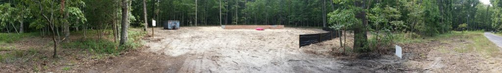

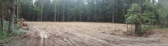

Re: Beginning stages of 24x44 with 3br/2ba on top
So a little update. I'm supposed to be closing in a month and they just started clearing my land on Friday. We have had so much rain lately that the equipment hasn't been able to get in to clear. I guess this is just the beginning with new construction.
Anyway, here is the where the building will sit. Things should begin moving a little more quickly now. The footing is scheduled to be dug tomorrow but we shall see.
