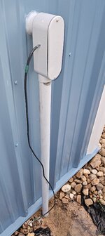

I've had some time to work on the electrical lately, and its coming along, albeit slowly. I installed a 100 amp sub panel in the shop, fed by a 2 pole 60 amp breaker in my main panel. I wanted the extra breaker slots so I went with a larger panel than I needed, but I would rather have excess slots instead of having to swap out panels in the future.
The new shop is about 10-15 feet from the house, so I ran UF 6 (R, B, W, G) underground from the main panel to the interior shop sub panel. I didn't want to tear up the rock pathway so I used a pressure washer and PVC to "surgically" bore under the walkway.
I ran the UF conductors inside of the buried PVC conduit that ran underground, and then up along the side of the shop. I picked up an 8' ground rod from Home Depot and hammered it into the ground within close proximity to the PVC conduit, then attached a 6 AWG copper stranded conductor from the ground rod to the panel. I didn't want to cut another hole in the building for the grounding conductor running to the grounding rod, so I drilled a hole in the PVC conduit box, ran the conductor through the hole, and caulked the opening with clear 100% GE Silicon, as well as caulking the opening in the shop siding for the PVC electrical service entrance into the structure. Although the gounding conductor is attached to the grounding rod and panel, I haven't secured the grounding conductor to the conduit or building yet. I'm not sure if code will require me to secure the conductor cable to the shop siding, or if it will be OK to secure the conductor to the PVC pipe, so I'll have to check and see.
Inside the shop, I got the panel mounted and installed on a piece of 4x4 plywood sheathing. I installed a grounding bus bar, which I can already tell has too few slots for grounding conductors so I'll wind up eventually having to install a second, or larger grounding bus bar in the near future. I used a flap disc to remove paint from the wall girt immediately below the panel, attached a 6 AWG copper stranded conductor to the wall girt, and ran it to the ground bus bar in the panel, which now bonds the panel and steel building together and grounds them to the grounding rod. I picked up some red primer to match the red oxide paint on the wall girder, and painted the attachment location.
