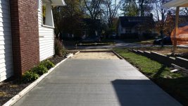

There has been a little progress in the last month or so.
The new driveway was poured in addition to a little sidewalk around two sides.
Mainly we are waiting on the garage door so we can get the final inspection. I am also waiting on the gas pipe run to the garage. Every time the guy is supposed to show up its raining or too muddy.
Once the trench is done and pipe inspection passed we can finally put down some sod to keep the dog out of the muck!
