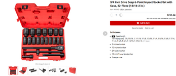

Looks like Harbor Freight is expanding the Quinn impact line to carry 3/4" drive now:
This looks close to the Tekton set:
I have a family members RV to work on (Diesel pusher), so I'm planning on investing into one of these two kits. Unless I win the lottery tomorrow or take out a mortgage on my house for the SO set:
Anyone have any experience with the Tekton set? I've only every broken one 1/2" drive impact socket (Quinn) and it was nice to run down to HF to get a replacement the same day.

Look for a ratchet with a longer handle.

^ I'd say to buy sockets, and not a kit with an 18" ratchet that you'll never use. If you're using big sockets like these, you better have an impact gun, or a 36"+ ratchet. The only time I use a 3/4 breaker bar is on a pinion crush sleeve; otherwise, it's impact time.
Agreed, I'm buying it for the sockets for this monster:
No need for the ratchet, I have two 3/4" breaker bars and a few cheater bars.

interesting tekton makes 3/4 drive in
6 point shallow
6 point deep
12 point shallow
but no 12 point deep and I think lots of axle nuts require 12 point deep?

I was able to buy this set today @ Harbor Freight during the parking lot sale for $132.00 plus tax:
That's a lot of tool for $132 bucks. I'll see if they hold up this Spring / Summer.
Tekton also listed a coming soon 3/4 impact socket set so maybe the same factory? Would rather get Tekton over HF personally.
Doubtful. Completely different designs.
Also Tekton is made in Taiwan and the Quinn is made in China.

Steel_Rain
Apr 23, 2024
1,586
Correct, not everything Quinn is China.
Correct, this 3/4" set is made in Taiwan. I inspected these last night and compared to my 3/8" and 1/2" set, these seem just as good if not better broaching. For $140 bucks, idk if it gets much better. I'll put these to the test with a 92 Prevo later this year.
I have lots of the newer gen Tekton impact tools/sets, and they have been great. My logic with Quinn/HF is the convenience, especially since I have 3 HFT's within about a 10 min drive of my house. The Tekton warranty great, but it won't help me same day/next day/weekend.
