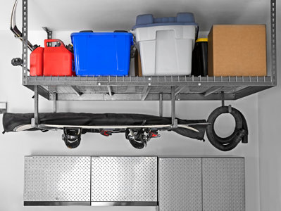

Other garage tips - pegboard/slatwall/storewall are your friends, and be sure to "look up" - meaning take advantage of storing things close to the ceiling (think ceiling-suspended/overhead shelving units), like this:

Rorin67,
I have been away for a few days. Just saw your last reply. Thanks a ton. Good suggestions, and in talking to the builder it looks like it can be made four feet deeper. That is going to be a huge help for me. With all the good suggestions I have received here I think it will work. I appreciate your comments. Enjoy that 67.
