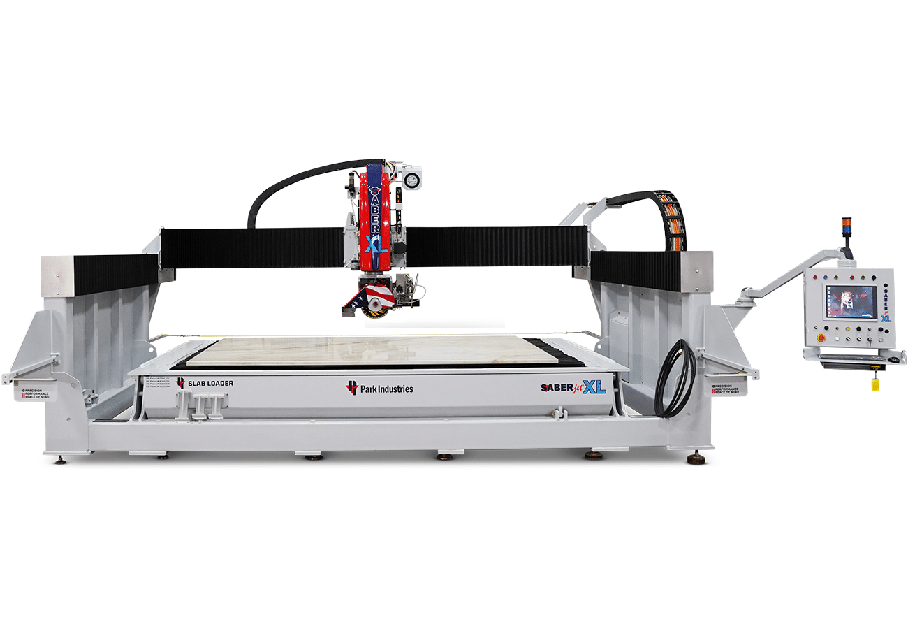

Good day,
I’m looking to put a deposit on a CNC stone saw. I am in a rural area and do not have practical access to 3 phase power.
The machine in question has requirements for 480v 3 phase 60hz and 35.7 amps at full load.
The machine comes with a step up transformer to take 208v to 480v. From what I can tell I will need an 80 horse rotary phase converter with a single phase 175 amp circuit to power the RPC.
I only have a 200 amp service to the shop, but I could potentially have a new 400 amp service brought in. I’d obviously need more than the 200 amp service to power the other necessities of the building at the same time.
But, instead of paying for another service I’ve thought about using that money for a 3phase commercial generator. I’ve talked to a few electricians here about this but I mostly get some head scratching as they don’t do much complex or commercial work.
Thoughts from any experienced electricians?

what is the HP rating on the motor? 30hp? Amps is not the factor to look at....
the 208v X 480v transformer isnt gonna work since your service is 120/240v...
Can you post a pic of the motor nameplate? it may be able to be rewired to 240v so you dont have to use a transformer.
or what is the make and model of the saw?
How did you determine that?
According to this chart (using 30HP as the sizing) you would need a 60hp rotary not an 80hp...

I don’t have a pic of the nameplate for the motor, just the requirements from the manufacturer, but I’m sure I can get it.
My understanding is that it’s a 26hp motor on the saw. It’s a 2016 saber saw by park industries. A 60 horse converter would probably be more accurate, which I believe requires a 150 amp minimum circuit.

It is not a simple matter to step up from 240V to 480V, when only single phase power is available, plus a transformer will only step up the voltage, single phase input is not going to create 3 phase. before jumping in better have everything settled power wise.

A 25 HP motor would use 19~20 KW at full power. Is the "saw" a combo water-jet and saw? The 240/480 step up is going to be a pretty big inrush when you saturate the transformer. Your PoCo may have limitations on the current inrush? A generator is the least cost effective way to power the machine where utility power is available. That and you would need a pretty good size generator to keep the power from sagging on a CNC machine. Probably more like a 50KVA gen set.
Start with getting some answers from your power company. Buying/ordering anything until you know what is possible could be a costly mistake.

If you plan on using the machine in production where efficiency of the electrical service is a consideration a phase perfect with a high conversion efficiency is more cost effective in the long run.
except that doesnt solve his 480v issue. he would still need a 240v to 480v 3 phase transformer which for the power he needs wouldnt be cheap...
I understand it’s more than stepping up just the voltage. If I get a dedicated 400 amp single phase service for the shop, it’s my understanding that I can use a RPC to get my 120/240 service up to 208V 3 phase, it just takes a lot more amperage to create the additional wave, basically doubling what is necessary, hence a bigger 400 amp service.
Why do you keep bringing up 208v? the RPC idler motor would need to be rated for 240v since thats the voltage you have coming in. The RPC wont convert the 240v down to 208v. only a transformer can do that. your understanding is totally incorrect.
There is no point in bringing up 208v. the transformer that came with this saw is useless with your single phase 120/240v service...

Bingo! many PoCos limit motor loads on single phase service to 10hp.... and if he's on the end of the HV primary line, he may have issues with voltage drop when starting such a big load....

I found this unit and was curious what the thought is on it. Its a 240v single phase to 480v 3phase VFD, rated for 25hp. I will hopefully confirm with the manufacturer tomorrow about the exact horsepower on the machine but I have a feeling its a little under 25hp. My understanding is that VFD's reduce inrush? I will hopefully also get some information from the power company too. Thanks!

Phase perfect are NOT static phase converters, they are quasi inverter/power supplies. They are very highly electrically efficient and they are rated for CNC machines with regen braking. They are the closest thing to utility 3 phase you can find.

I got some more specs on the machine after the manufacturer ran the serial number. The machine itself has one power source input requesting 480V 3 phase 24.7 full load amps. The actual motor/spindle is a 15HP motor with 18.2 full load amps that is not wired independently but within the wiring of the machine.
It sounds like the phase perfect digital phase converter is the way to go. Phase Technologies says it keeps voltage within 2% and has the capability to also double the voltage without the need for an additional transformer. Cost on the complete unit is $6400. They also claim that because the way it soft starts there won't be any inrush and that it won't effect the grid.

One big question? Is the incoming control power separate from the incoming power for the motor? If not, can it be separated?
If the incoming power runs to both the controls and the motor you have more issues. A soft start for the motor won't work if the controls need 480v/3PH all the time.
I would assume the controls can be powered separately, but it might be worth checking into.

Thats a good point
He did say the machine only has 1 input.
If the control power input cant be separated out then the phase perfect wont work like he wants it to.
