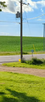

Piggybacking on this. Wondering how my place is. 2 transformers. My understanding is 1 makes leg a and leg c 120 to ground and the other is for the b leg for 3 phase only that is 208 to ground. Not the best picture. These are for my property only.
Thats an open delta bank.
N-L1 120V, N-L2 120V, N-HIGH LEG 208V, L1-L2 240V, L1-L3 240V, L2-L3 240V.
that drawing above is pants on head ...very co fusing way to draw that. Gave me a headache.
Codyboy
Jan 31, 2019
1,617
S.E. TEXAS
You have this. But with only 2 transformers.
The red circle transformer is eliminated in your case and the delta triangle is open instead of closed. Doesn't matter you still get the same voltages .
thats correct. its called an OPEN delta. same voltages as a CLOSED delta (3 cans) but only 58% of the capacity of a CLOSED (or full) delta.... watch out for that stinger/hi-leg....

Brandon_oma#692
Apr 20, 2011
260
North West corner of Illinois
Just got home and looked. 25kva and 10 kva. I am guessing it is what they could find that day. Comed (utility) was actually here before the Sherriff as they were on the way back to the yard from some other job and came to my mess as a surprise. They had to go get everything and I had power a few hours later. Just realized today what the sizes are. They said to call if I ever had a problem and they would swap them. No clue how much power I can pull?
Someone ran off the road and took out the pole a couple years ago. I came home from work to the pole in my driveway and the transformers busted open all over.
