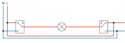

So recently I moved into a new house and I'm trying to figure out some of the electrical wiring done by the electrician/plumber that was in charge of the electrical installation.
So far, with the things discovered, I'm really feeling lucky I don't have water coming out of the wall sockets.
This is one of the latest discoveries... I have a 3 way switch on each side of stairs... One on the bottom, one on the top. I wanted to connect an additional switch for another light on the hallway, which would be separate from the 3 way circuit.
I did a quick sketch of the wiring I found... Traveler legs on the 3 phase switch are connected to phase and neutral on both sides and the light fixture is between both commons. :wtf:
So is this guy a genius or should I never let him touch another wire... I'm definitely on the latter side...

IMHO, the diagram I am looking at probably would not work. If that is really an accurate depiction of how the circuit is wired it won't work properly.
You wrote about "the traveler legs on three phase switches" if that isn't a typo, please find a good book on basic electrical wiring.
If what you want to do is add an additional control point for a lighting circuit with two three way switches you need to add a double pole double throw (DPDT) (4 way) switch to reverse, or flop, the travelers. There is no real limit to the number of DPDT switches you can add.

I find it hard to believe that someone wired it that way. Your use of "3-phase switch" has me questioning some things here.
But if that is a true representation of how its wired, then its completely wrong.
Can you take some pics of both switch boxes showing wires coming into the box as well as wires on the switch terminals and post them here.

It does work and it was common about 80-100 years ago. I have one in my own house.
It has not been an acceptable way to wire a three way switch for a long time. Hopefully this isn't a newer house.

No, as drawn, that circuit will go boom and trip the breaker in two out of four possible switch configurations.

Look at it again, the state it is in now, you have just the neutral potential at each side of the lamp. Flip switch #1, now you have the hot and neutral at the lamp, lamp lights. Flip switch #2, now you have the hot potential at each side of the lamp, lamp goes out. The hot and neutral never come in contact in the switch.
Oh, that’s a lamp... I didn’t read that symbol as anything, as it isn’t.

The circuit actually works. I really didn't pay much attention to it until now, because I wanted to add an independent switch to the box #2 for the light on the hallway and had to get hot and neutral from somewhere...
Circle with the cross is a lightbulb... those funny Europeans use it like that :dunno:
The benefit of it is that the guy that wired it saved himself one wire in the conduit from box 1 to box 2, however I'a bit reluctant with the state of having hot wire on both sides of the bulb when it is off.
If it is wired with conduit it is an easy fix. The travelers between the S3's need to be independent of any other circuit conductors.

Schematic wise it will work, but is not acceptable wrt the rating of the three way switches used for house wiring , in Sweden .
Having phase and neutral on the NO and NC terminals can easily lead to a arcover when the switch is flipped, especially so if you have anything else than an incandescent lamp load. Fluorscent lighting ( cos fi appr 0,7) will probably cause a flash over phase to neutral at least 1/3 of the number of flips.
It was common and accepted practice in Sweden until fluoroscent tubes came , and also the rating of the switches were cheaped down. A typical 3 way switch here today has just the smallest insulation distances that will work and pass IEC and the minimum amount of metal.
I suspect that none of the white wires are in fact a neutral. They are marked black indicating a hot traveler switched wire.
The actual neutral is probably terminated at the load. Only the hot wires and traveler returns are connected at the switch.
