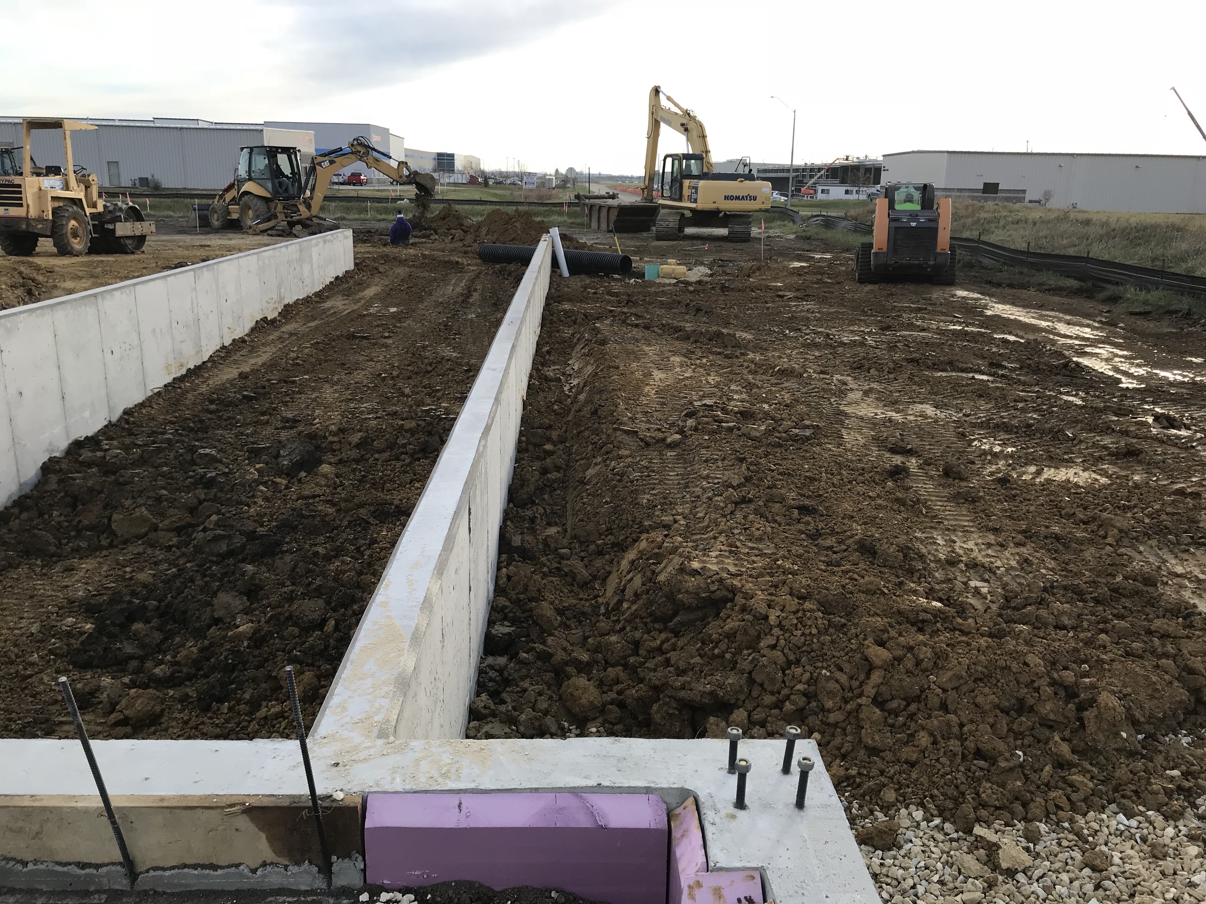

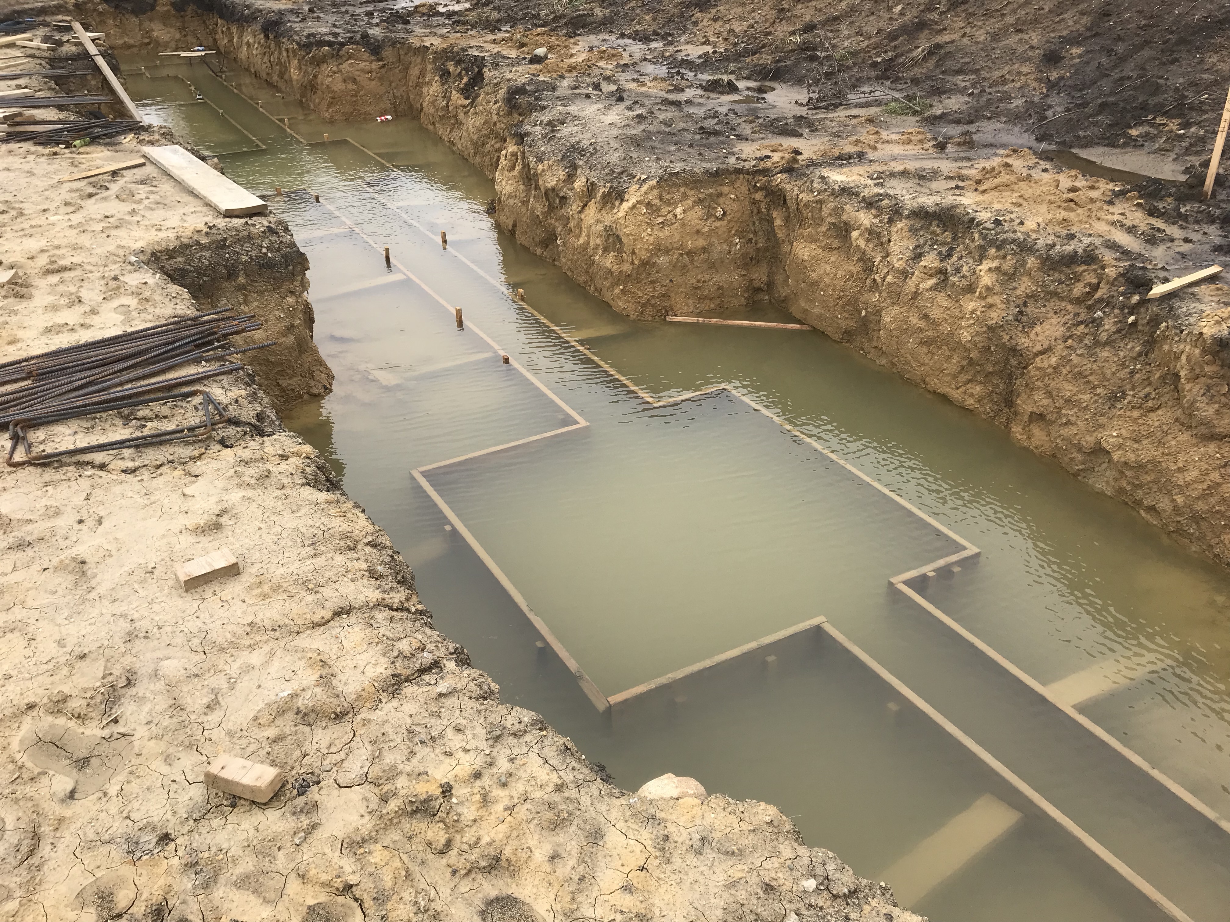

Building a new 30,000 sq ft shop for our Manufacturing business - follow along for the process!
Currently the foundation is poured - and it took forever. With the record rain we have gotten in Iowa this year we are about a month behind schedule on everything and the tentative move in date will be June 1 2019
Some shop details
30,000 total sq ft all free span - approx 1500 sq ft of that is office space
Dims are 320' x 100 ' - a portion of the building bumps in for the semi dock
1 x dock door for semi loading
3 x doors for fork truck travel in and out of the building. The largest being 26' wide
Here is a view of the dock walls - let me know what else you want to see

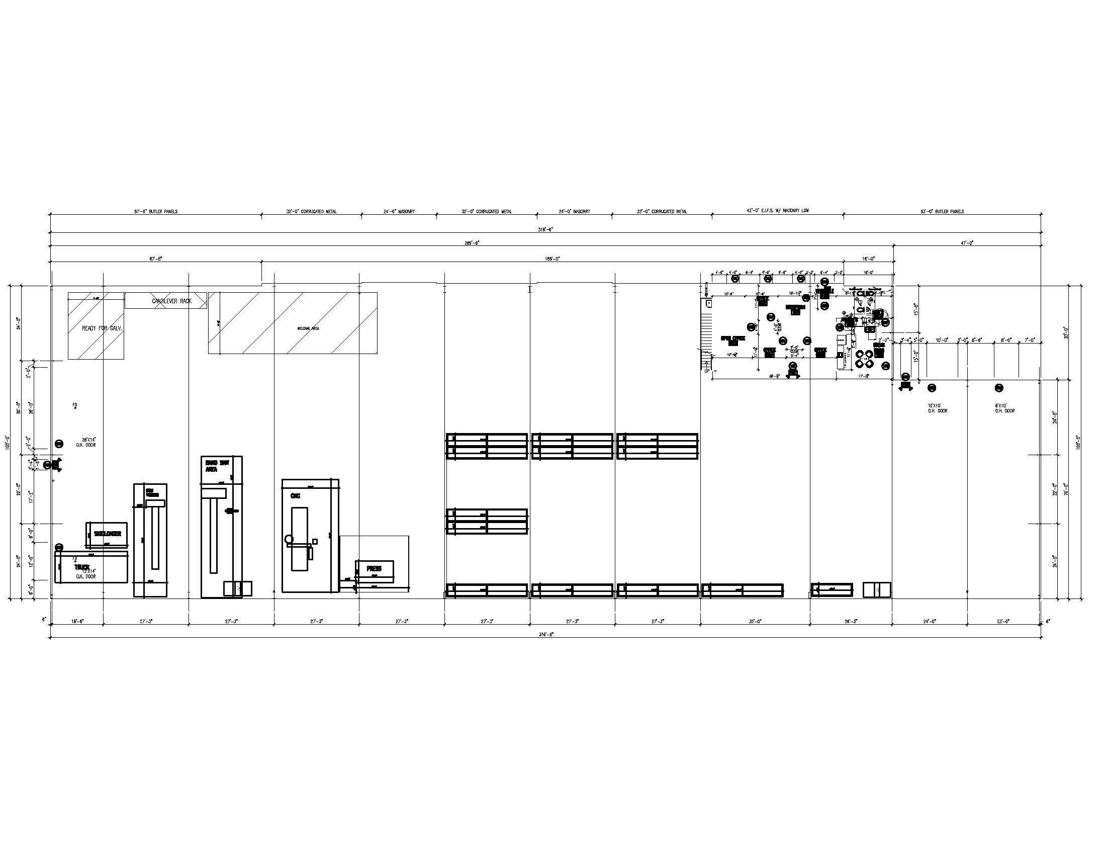

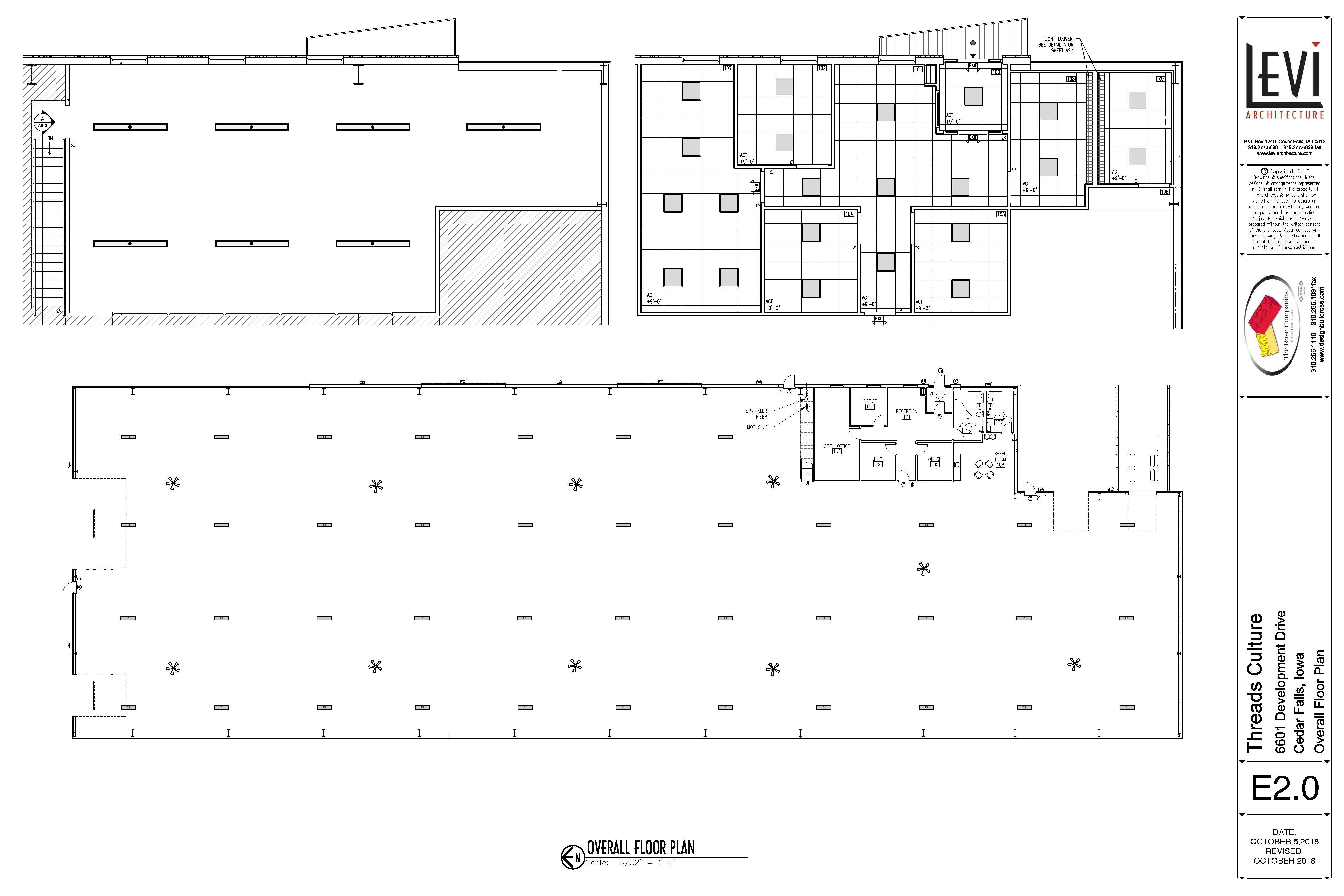

Here is a tentative equipment layout. Currently undecided where the Plasma table will go.
We were able to spec the spacing of the support columns to accommodate the pallet racking with very little wasted space.

are you going to divide the warehouse space from the manufacturing space?
What kind of workflow analysis have you done with this layout? I'd highly suggest building a model of the building with your machines so you can move it around and get a feel for how it works given your workflows.
Also find a good way to vent around the plasma table
Oh yeah - this is version #87 of the shop layout :). I watched NYCCNC's video on 3d printing equipment - that would be fun.
We started the process on a white board, then modeled everything in solidworks and moved it around in there.
As far as venting goes - we will have two airmaids above the welding area and one above the plasma table. I haven't decided if we are going to do a water table or a down draft table - either way we will filter as much out as possible.
We are trying to do with without the use of overhead cranes. If possible I'd like to use gantry cranes above the saw and iron worker for items we cant load by hand or with the fork truck. I prefer loading the conveyor with the truck myself, but I'm not the operator so I'd like to give them options.

How does material flow through your space? it looks like it crosses over a bunch. With all the equipment on that one wall so close together won't it be crowded? genuinely curious what kind of process flow you have.
S
stewie97
Jul 5, 2012
59
Material comes in through the 26 ft door and is staged at the cantilever - unless it is precut then it goes straight to welding.
If we do have to process it in house it typically will flow from one machine to the next - iron worker to the press or CNC, or saw to CNC.
Once it it processed it goes to weld then to hot dip, or straight to hot dip.
Very minimal criss crossing, and we don't want weld cells close to the machines.
The boxes we have around the machines are better described as their "area of influence" - not even close to being crowded honestly.
Take for instance the press - it has a 12' bed, but we are allowing close to 27' for it's area. The largest part we punch on it Is 6.5' long - so plenty of room to stage material around the machine. It is the one piece of equipment we can't move without spending a fortune to do so, so it will be locked into place. The cnc would cost $ to move, but not nearly as much as the Press. The saws, iron worker, and future plasma can all be moved with a fork truck, so no issues there.

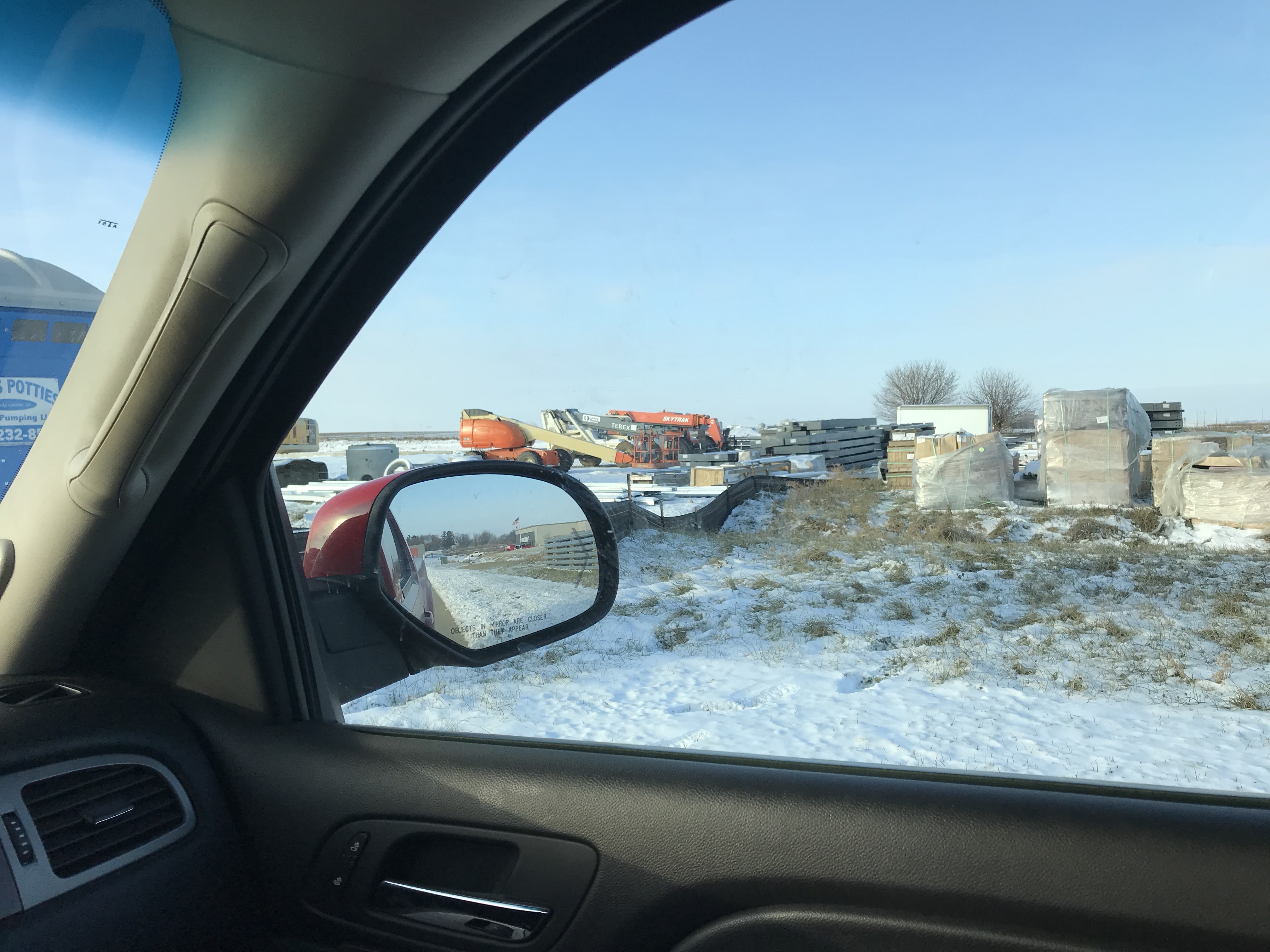

Small update - the lifts are on site. The crew is supposed to start erecting the steel Monday or Tuesday after the holiday.

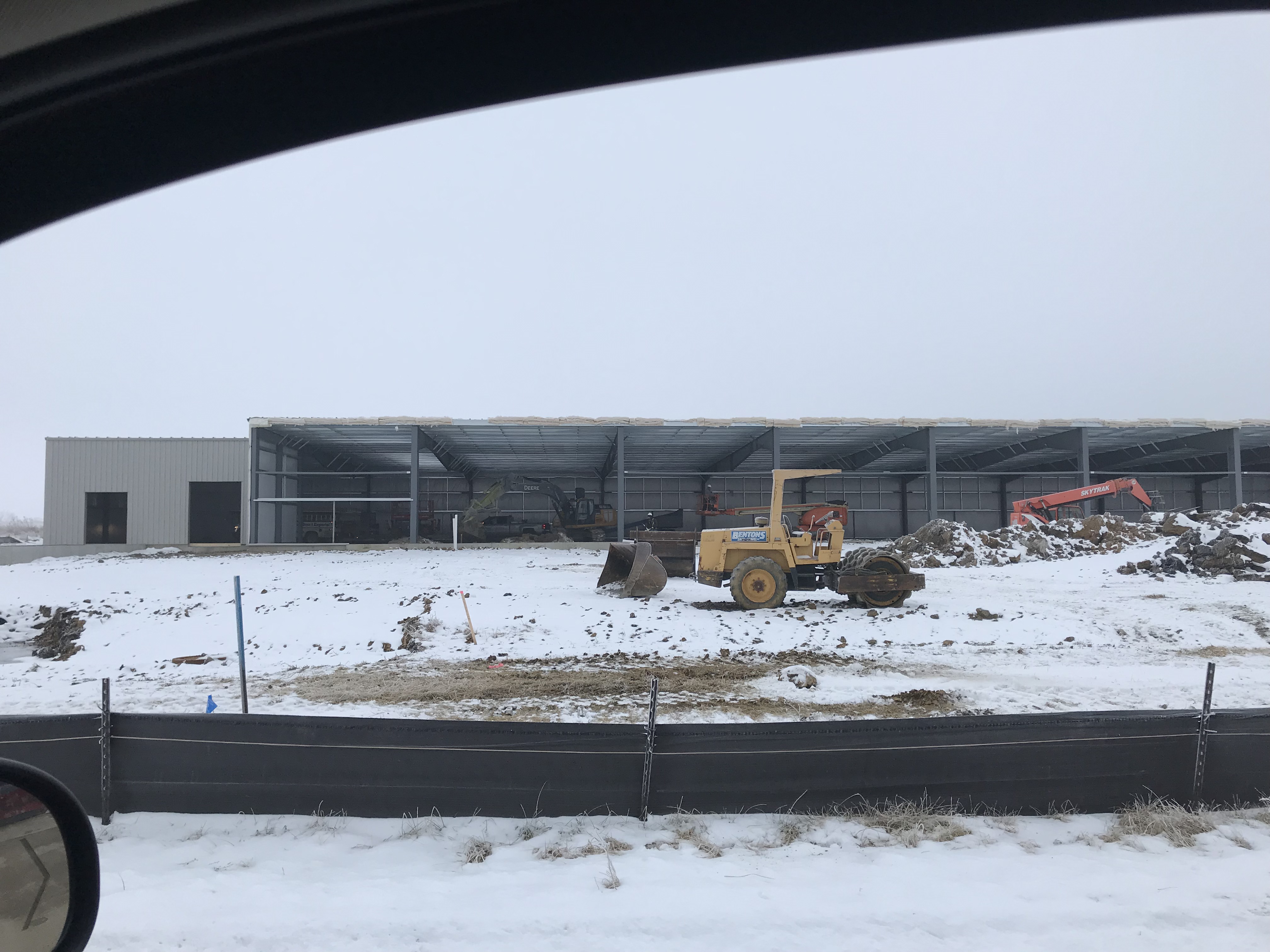

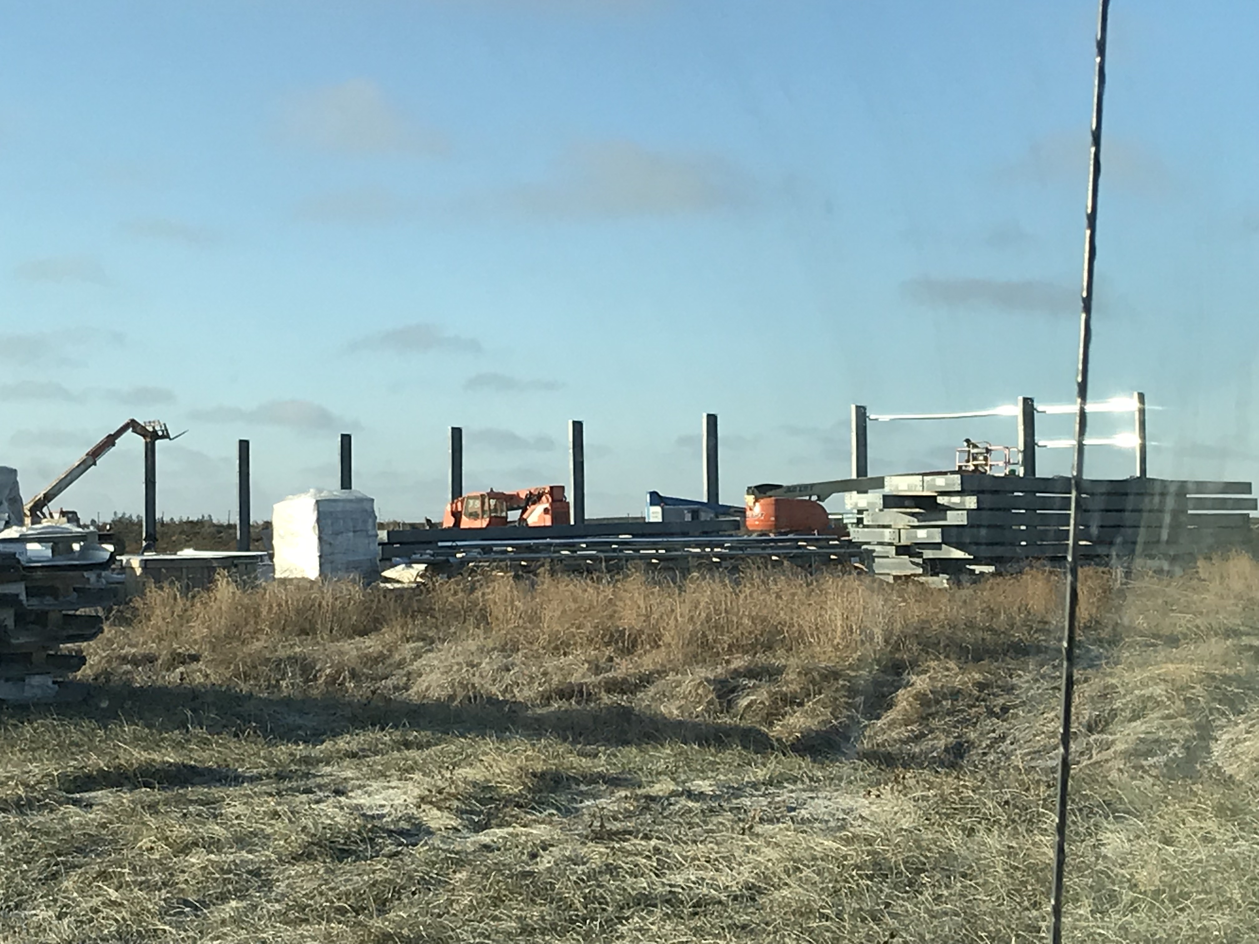

The back wall uprights are going up - I don't envy the guys putting this thing up in the cold. I'm not even going to get out of the truck to take pics!

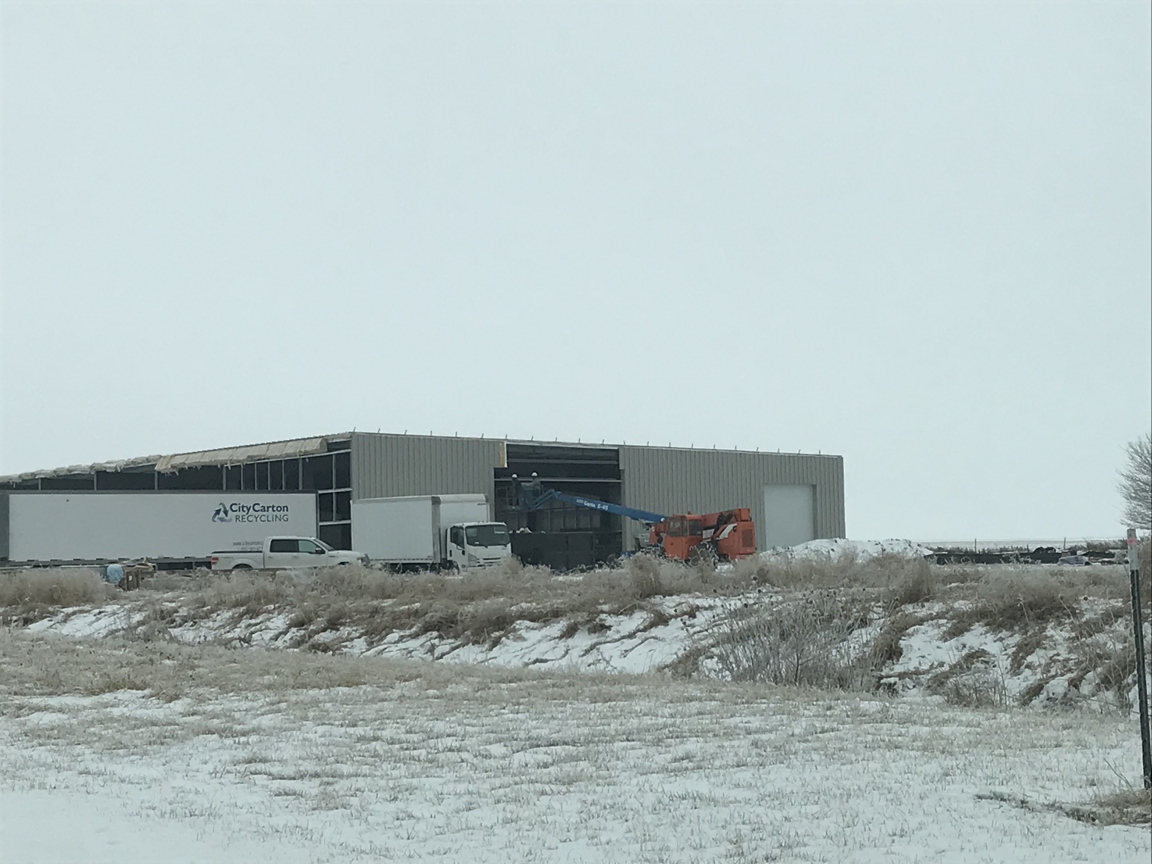

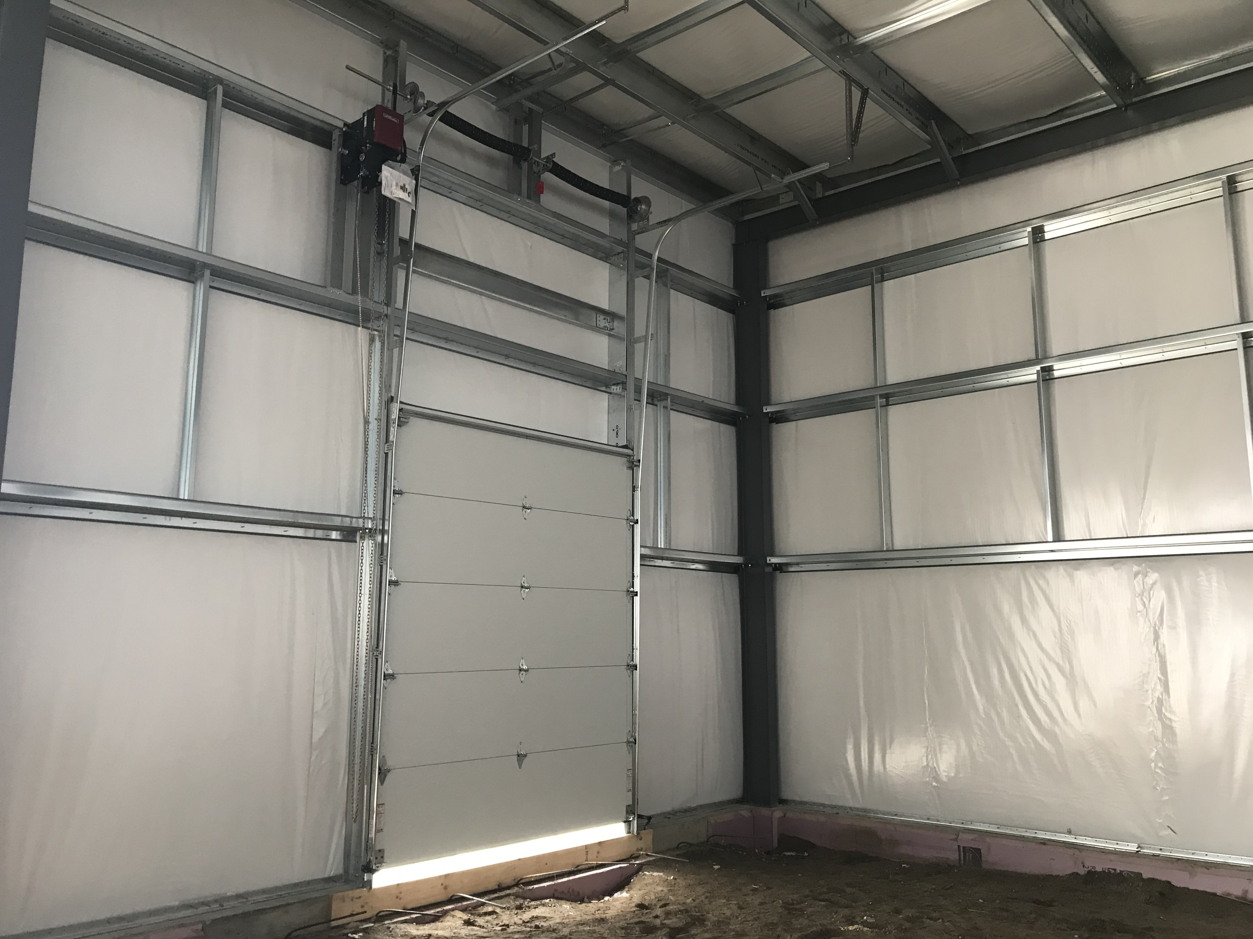

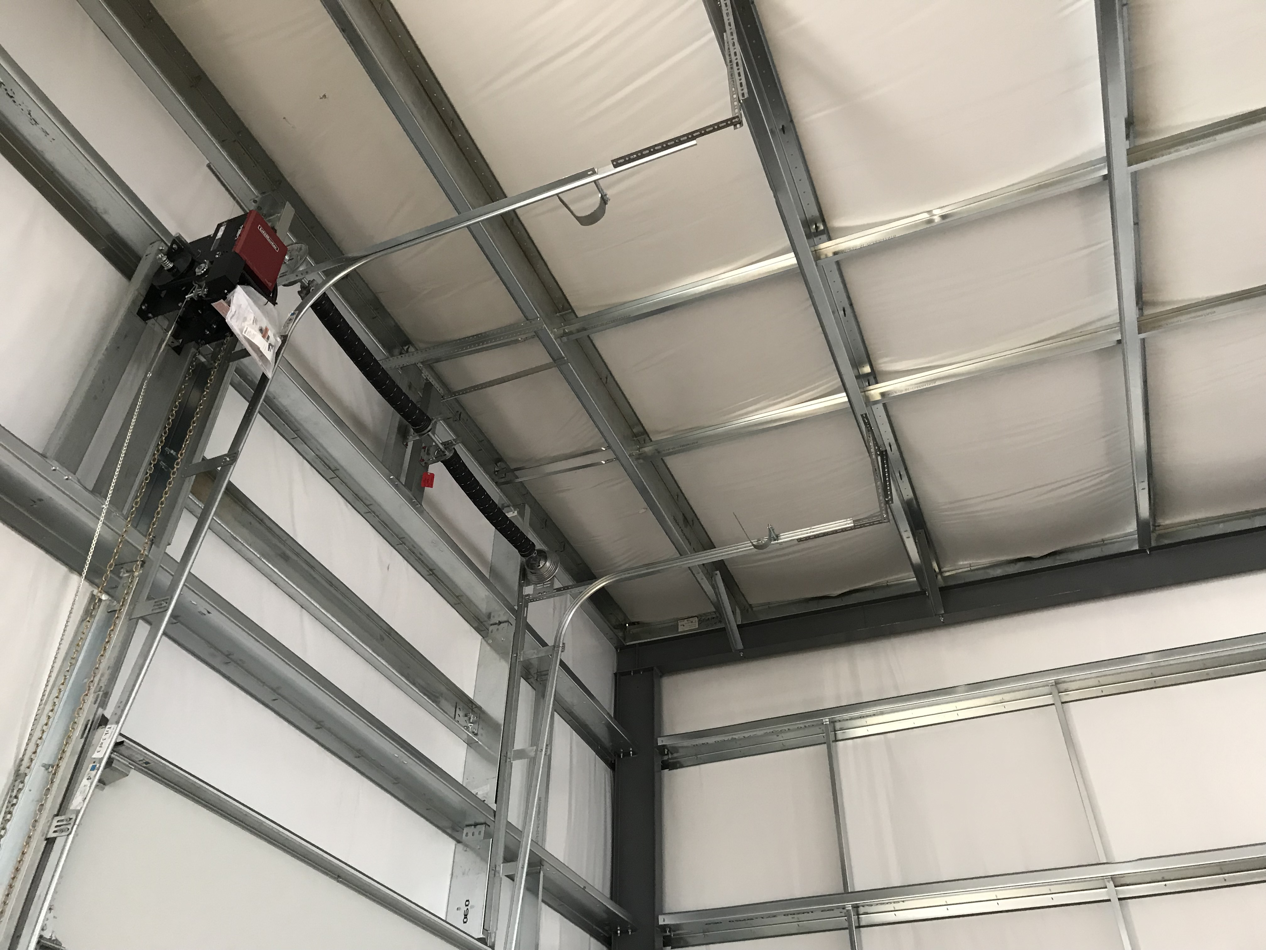

Its way past time for an update - the roof is on and 2/4 garage doors are up. Small snafu with the 26' wide door. It was supposed to be 14' tall, not 16'
