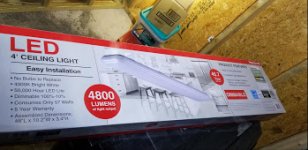

Would like recommendation with installing LED lights in my garage. I have a total of 32 outlets boxes with 5 on every other bottom cord of the truss except around the stairs going up to attic storage room. They're spaced 4ft from each side wall, down the center of each garage door, and center of the garage. I initially wanted to put them 2ft from each sidewall but they would interfere with the garage door horizontal track. any recommendation will be appreciated.

Platonic Solid
Nov 29, 2014
3,587
CT-USA
Missing critical info = ceiling height
For better response include link to fixture purchased.
For even better response include link to fixture IES file.
Platonic Solid
Nov 29, 2014
3,587
CT-USA
4800 lumens is way underpowered for a 16' ceiling if this space is being used for wrenching. Fine for storage/parking. Also, 84 lumens per watt is poor efficiency for an LED fixture.
See this post (link) for better fixture for your application (assuming wrenching is the goal).
Platonic Solid thanks for recommendation. How many PLT-90097 LED high bay lights and spacing would be best for wrenching.

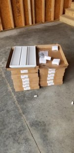

Attached are pictures of the PLT - 90098.
Quick review:
- Customer Service: Sales Rep called 30 minutes after I placed my order to confirm and provided contact info.
- Shipping: Didn't expect the lights to arrive so soon. Ordered Wednesday, arrived Saturday via FedEx.
- Packing: 13 Lights ordered in 3 boxes consisting of 5/5/3. Plenty of packing peanuts to prevent the lights from shifting while moving or damage.
- Construction: Overall lights are well made out of durable material and easy installation with hanging using chains. Lights are very light, I was able to climb scaffold with one under my arm. Weighs approx. 10lbs.
CONS:
Mountable: Wish they can be easily mounted between trusses by adding few screws. I will have to construct 1 x1 purlins to flush mount with ceiling.
Overall. very happy with price and product. I connected one light and was impress with the brightness of the light. 13 lights will definite light up this garage.

imjustdave
Apr 9, 2014
204
Sumner WA
Quick review:
CONS:
WOW awesome photos, appreciate you taking the time to share them. obviously 1 light isn't enough but it's a good representation and what's to come. :thumbup:
I assume overall your happy.
