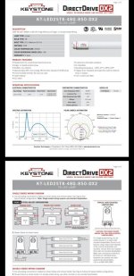

Got all the lights up today! They are 8ft fixtures with 4 LED bulbs. I ran 8 of them and man do they light the place up!
