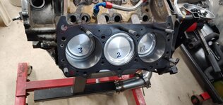

Right now I have the motor out and apart. I actually lost ring tension on the #1 cylinder due to a mis-hap that was 100% my own stupidity. I inadvertently had a timing table for wheelie control active with a cell that added a **** ton of timing to the motor and I somehow managed to activate on the 1st pass at MIR. I found it and we inspected the motor and everything looked fine and really it was as we made 3 more passes including the 8.36 pass without incident. When I got home and looked at the EGT's though it was evident #1 was not happy and on its way to a really bad day. Fortunately I lifted in time before we got to that point. Care to guess which EGT is #1 lol!
Sure enough the #1 spark plug wasn't happy either
I bought this borescope on Amazon and was excited to actually use it. The pictures are amazing.
It works quite well and the piston, bore and valve all looked mint.1733402492322.jpeg
I ran a compression test and the #1 was down to 130psi which it was recently 150psi so I knew it was hurt. I leaked it down and sure enough it was only 65% while the other 5 were 90-92% and the same as the previous leak down I did in October. So its back out with the motor.
I was planning to pull it anyway to do the cam swap plus I have been chasing the oil pressure issue in 3rd gear that has been plaguing the motor since we 1st put it on the dyno. With close to 1000 miles on it and around 30 passes I figured it was worth a look see before we haul down to Sick week.
The #1 cylinder just lost ring tension, the piston, valves etc all checked out fine
The main bearings didn't look to happy though, especially the ones in the caps.
At first glance you would think its the oiling issue in 3rd gear which looks pretty bad on the datalogs
I have been aware of this issue since early on and have been trying to fix it. I am running out of oil in the pan but with the way my system is set up the Oil accumulator catches this BEFORE it reaches the motor so the bearings still have plenty of oil and the pressure never drops to lower than 45psi and that is usually only very brief. Plus the rod bearing all look pretty mint if the issue with the mains was related to loss of oil you would certainly see it on the rod bearing too.
Since the heavy wear on the main bearing is on the cap side and is mostly on the #3 and #2 caps it appears the things are moving around or the clearances are to tight. I am at 3.5 thou on the mains which for a 2.5" main journal diameter is about a wide as you would want to go. It appears the issue might actually be the motor mounts! I don't run a mid-plate with this motor and the motor mounts pulling on the block side skirts appear to be the issue. What is interesting in the center two caps on this block are not cross-bolted like the original block I had in the car earlier in the year. We did not see this kind of wear on those main bearing, but then again we did not have as many passes on it either.
I am addressing the oil issue and have a solution we are investigating. I am fairly certain on what the issue is and how we plan to fix it. I do really need to add a mid-plate to this motor but I don't think I am going to get it done before Sick Week. I will post more we have a lot to do in the next 52 days before Sick Week. The motor is getting a new cam which we will only be able to test on the dyno which we will hopefully be able to do at the end of this month. I also have some exciting upgrades I will post up.

How do the cam bearings look? I would think if the cam bearings and rod bearings are looking good it has to be something other than an oil supply issue as they are the last in the circuit. :unsure:
mlyonsdc
Nov 23, 2018
238
USA
Cam bearings are fine and I agree with you I don't think it is a problem with oil starvation. I am pretty sure its the caps moving around due to not having a mid-plate. I can't see it being not enough clearance with 3.5 but I can go wider as it is 3.5 with a .001 bearing! I may mix a set and take it out to 4. I am taking it out to my machinist tomorrow to discuss a plan. The oil issue in 3rd gear is the oil getting trapped in the valley. The BMS blocks are meant to be dry sump blocks with scavenge systems they do not have enough drain back to the pan. A lot of race teams would epoxy the valley to make oil drain to the rear. I think we are just going to drill some holes in the valley. I am also going to squeeze another 1/2qt in the pan. I really need a larger volume pan but I am really limited in what I can do with that due to the crossover location.
My block oil gets trapped in all of those recesses

It will be interesting to see what your builder recommends. Please keep us posted after the discussion.
The bearing problem was definitely a clearance issue. I know the first set of main bearings I tried were 3.5 but I think I ended up using a +.001 bearing Speed-pro bearing since the original Clevites in this motor were plus one which put me at 2.5 and Clevites are usually tighter than FM. I just went back to a STD FM bearing which put the clearance back to 3 and should work well. I debated replacing the rod bearing which looked good but my machinist suggested a little more clearance. I had a +.001 Clevite H bearing in them and made a split set which moved the clearance out to .003 on the rods too.
The oiling pressure issue in 3rd gear is NOT causing a bearing issue but is an issue that still needs addressed. The oil is definitely getting trapped in the valley. We removed the epoxy screen that was in the front which made a big difference. I moved to a bushing lifter from the Comp needle bearing lifters after HuH. So if I have a lifter failure it is more likely to be contained and not send parts into the front cover and timing set so we just eliminated the screen and restrictive epoxy.
We also drilled four drain back holes in the cam tunnel and valley. We tested it on the stand and primed the engine with no intake on and it really seemed to make a big difference. While its not ideal dumping oil on the cam and crank nobody seems to think the extra windage it will create will make much of a difference on this motor.
We also looked at the oil pan. I can cut the bottom of the sump off and extend it an inch to give extra capacity but it is going to be a lot of work as I would have to re-do the pick up and baffle.
We also tested the pan on the stand and found we can get just under 6qts in the pan before it starts backing up the turbo oil return line. 5qts would take us to the shelf below all the oil drain backs. For now I am going to run it on the dyno with the new drain backs in the block and extra 2/3's of a qt of oil in the pan and see how it goes. If we still have the issue it is not a big deal to pull the pan off when its in the car still.

After I got the car back together we put it on the dyno to re-adjust the tune for the new injectors. We also tested different fuels and made a bunch of pulls tweaking fuel injector scaling and playing with ignition dwell times for the coils. We didn't run the car on kill but made all of pulls at 30-35 psi which is still north of 1000rwhp. We did pick up some power with the changes and were excited to get back out to test in early May. 3&4 are slightly rich 1&2 lean and 5&6 perfect BUT #6 was also our hottest EGT and #1 was cold for some reason. #5 is the only one that seemed to be spot on.
We went to an event at DW42 for the B3R event with the changed we made on the dyno and I also did another stator swap tightening the converter we were hopeful to see at least a 5.0 pass. We made a couple hits on the car which showed a lot of promise with the first pass running 5.21 with the traction control pulling 2-5 degrees of timing the entire pass. We were on the right track but the last pass I noticed the oil pressure was dropping under power.
On the last run I had 35psi going down the track! It made 45psi at idle and ran fine, really had no idea other than the data log. I went back and started looking we had 80psi on the Dyno but it was progressively getting worse after that. It was kind of funny because Ray and I were sitting there and I was looking at the datalog not saying anything until Ray said what are we doing you ready to make another pass and I didn't even look up and said no we have no main bearing left and he looked at me absolutely stunned because the car just ran a 5.28 and was still running!
I literally had no #3 main bearing left. Nothing but a steel shell in the cap and a small amount of copper on the block side!
I really can't believe we were making 5.20 hits like this and drove the car 75 miles on the street for the drive portion at this event! I know this much I will never NOT run a belt drive oil pump that's for sure. The ONLY thing that kept this motor alive was the fact that it had a lot of oil pumping through it.
Me at a check point with no ,ain bearings lol
The rest of the motor didn't look horrible, #2 main is the thrust bearing it was ugly too and got hot #1 and #4 weren't pretty but still intact. Only one rod got tore up #4 mostly from **** from #3 main, the rest looked good other than trash going through them. The crank was toast, it had some heat cracks in the #3 main journal and #4 rod bearing which was expected. My machinist said there was also some torsional cracking around the oil holes on the mains which he is pretty much telling me we don't have enough crankshaft for what we are doing. Which I knew adn TBH when it was making over 1300 on the hub dyno I was cringing and waiting for that crank to come apart. I actually took a set of main bearings with us to Sick Week as I knew it was still an issue. I just never checked them and between Sick week and early May we had over 50 high power pulls on the motor. I should have checked them earlier, I probably would have been able to roll a new set in and rock on.
So I am going to put the Billet Crower crank from the original motor in this block along with the better Crower billet rods and Racetech pistons. The original block was cracked and we repaired it but have been hesitant to use it since the crack was so close the deck surface which is what caused our issues at the 2024 Sick Week. If the BMS crank can be repaired I may throw that rotating assembly together in the original block as a back up.
So we missed the Buick Nats at Bowling Green but I got the motor out and to my machinist who was back up as usual but he got it done and I am putting it together now. The best I can get with the Crower crank is .003 on the mains. I did find a race bearing that King makes that will work and they have it in a X size but I can't get them till October so this is what I will at least start with.
To fix the issue I am also putting in a mid-plate which is long over due. Ray got creative and somehow made it all work and it attaches on both sides of the frame. I can also add a driver side motor plate but it will take a lot more fab, it would be almost impossible to get the passenger side with the header turbo arrangement we have now.
Drivers side was pretty easy
Passenger side was a little challenging
I am also changing oils to HPL Synthetic straight 50w. So we will see what happens with that.
We have been also making some other changes to possibly race Limited 235. This all started with me wanting to go down South this winter to at least watch the Winder Series of ProMod races and considering doing one of the Radial Outlaw series races in conjunction. Plus my car fits the class pretty well and if I can run 5.0s with the spec turbo I could be pretty competitive. I had an extra set of dbl beadlocks from Mac Fab so I pick up some tiny 235s to test.
I also picked up the spec turbo it has the same size turbine wheel and should have been a straight swap for the NLX88 on the car but NOO the housing flanges had to all be different!! We ended up making a new alum downpipe and IC pipe it was a nightmare but it is on and I can swap back and forth it need be.
We are bringing the car back out this fall with a bunch of changes, stronger crank, oil and oil pan upgrades, mid plate, new smaller 76mm turbo and 235 tires. While I have been quite we have still been busy!
