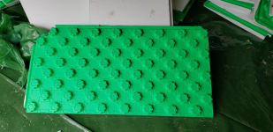

An option that saves labor when installing in-floor radiant heating lines is Crete-Heat (https://crete-heat.com/).
Each panel is 2' x 4'.
The "hockey pucks" secure the heating lines and ease installation.
Each panel is 2" thick = insulation.
Panels are available to support 3/8", 1/2" and 5/8" tubing or 3/4" and 1" tubing
The panel can be easily cut with a blade
Each panel is designed to overlaplink with the next
Sorry for the dark-ness of these videos; no lights were installed yet when they laid the heating tubes
Little better view
As you can see
  • No need to wire tubing to rebar
  • Saves time on installation
  • The only place large staple-like hoops were used was around tight corners
  • May save $$ as Crete-Heat is 2" insulation
No tubing was placed in that rectangle (foot print for 2-post lift)
My concrete guy had never seen this before. He inspected the Crete-Heat before my pour. He was impressed and the pour was uneventful.
