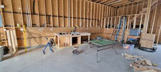

It's been a while since I posted anything, or actually did anything meaningful to the garage. But below are some pictures of my weekend project........insulation in the walls behind the OSB, installed the OSB and built a miter saw workbench.
Eventually, the workbench will extend left to the pony wall and then all the way to the right and then past the blue 10' ladder. Sink will be installed near the ladder location.
