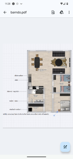

Hello, obviously new to this forum and just looking for some suggestions/input! That's a rough sketch of the future interior of the barn (1200sq/ft) of it. We are purposely keeping plumbing on one side of the building, is it easier or allowed to stub plumbing out of the building and basically connect all your drains from the outside..or Is it better to have everything dug and connected under the slab? Looking for suggestions, thanks in advance!

So we're about to have the entire barn floor poured within the next few weeks, if you look back at rough drawing on how we want the layout I want to make sure we get everything in before the concrete!! Maybe some can help and make sure I'm not missing anything. We need to have all the plumbing trenched and stubbed out of the barn ie. Kitchen sink drain... Tub/shower drain.. toilet...vents for all plumbing... bathroom sink drain... Washer drain... (We are probably going to put stackable laundry into the bathroom now) Ummm do I need the gas line prepped and ran through the floor? Or can that come later through the wall? Main water line?? Electric?? We have a pole about 300ft away but I want everything underground so it will come down the pole into meter and all underground from there.. if I'm missing anything please let me know! This board has been awesome, thanks in advance!

I like the setup.
Gas can be exterior. I'd get all the plumbing in the slab... Are you hiring a plumber? Messing up the drains would be very bad and costly.
Keeping everything to one area is smart and it will make things a lot easier and cheaper.
Make sure you get a sink in the shop area

Yes I was going to purchase everything and then let the plumber and excavation company take care of the installation... Im going to go over everything Saturday and see what is needed.. my brother built a 46x106 barndo few mins down the street so we're going to go over everything he did and hopefully I don't miss anything! This board has been a blessing needless to say! Thanks for all the help so far
