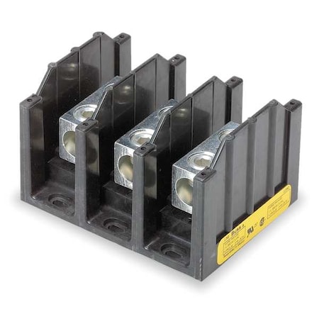

The issue with SER undergroud is that the conductors arent rated for wet loctions and can develop issues when exposed to water, especially when using AL conductors...And conduit does fill up with water no matter how good it was done! The conductors can turn into a paste like substance if water gets into the conductor through a nick in the insulation...
Yes u would need j boxes and split bolts or kearney bolts which arent cheap...
What about some fargo connectors, or a parallel groove single bolt connector?
Or a splicer terminal block, like this one that's $58. I like that it's less of an issue to insulate the fargo or split bolt connections from one another. I would still need another device to bond the EGC together.
I like the wireway trough idea and I can see what you're talking about. However, I can't find where I would be able to buy one... Looks like I would need at least a 4x4 or 4x6 in trough. Of course, also having trouble finding that big of a j-box. I think it would need to be at least 15" across (6 x 2 1/2" SCH 80 PVC for j-box with splice).
Since the SER feeder I have now is existing and this isn't a remodel, just a service upgrade, if I were to use it without modifying it, what are the chances the AHJ is going to give me flack about it? I could plan to fix it when I replace the deck and have everything between the shop and house pulled up, so that I can really do it right and clean.
