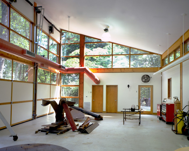

If you did use free span rafters for even part of the garage you could possibly have your overhead doors go straight up like this:
Just a thought. I would price different options.
