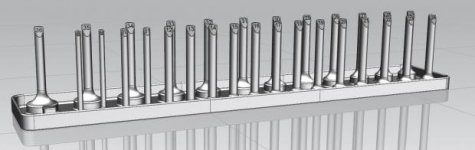

I've been doing that right now. I designed a Hansen Global knock-off for larger impacts, and am printing it now.
If the picture works you can see the rendered version. Just about done printing 2/3 pieces.

Seems like a lot of work and money to duplicate something that sells for less than $14.00.

They don't hold sockets over 27mm, and still skip sizes. I have impacts up to 36mm, and wanted some place to put them.

That is awesome. I would love to be able to print up whatever combination of socket holders I need. I have so many random sockets in my drawer that I haven't been able to find a solution to. Things like large sockets, specialty sockets, torx, etorx, hex, adapters, etc.
Curious how much a tray like your picture costs to print? Don't have any experience with the 3d printers so don't have a clue if it's 2 bucks or 200. How long does it take to print something like that? Also what printer would you need to do something like that? Will a "cheaper" one work or do you need something special/more expensive. I would love to get a printer sometime in the near future for the kids to play with(and me!). But if we do get one it will just be a basic cheap one since it's a luxury. These socket rails just might be the excuse I need to pick one up. Ya, doesn't take too much to twist my hand.

Thanks! The CAD took a surprising amount of time because Gearwrench has spotty quality control, so I had to redo a lot of it.
As far as cost go, you're looking at about 250m of material all said and done. (100% infill) Filament for a printer usually comes in 1kg spools, which are about 300m long, and cost $23. So that would be $20 in material. No clue what the power usage is on that, but there is some hidden cost there.
Printing time on that would be about 45 hours, about 15hrs per piece.
I use a Prusa i3, which is an "open source" type of printer. Prusa makes one themselves, but a bunch of Chinese companies take the design and sell it. Mine specifically is made by a company called "Hictop," but any one on amazon you can buy for around $230 should work fine.
Once I'm done printing and changing everything I'll upload the files to Thingiverse, so anyone can download them for free and print them off.

What are the 3 pieces? 3 pieces to make one socket tray in your picture or are you make 3 trays like your picture. 45 hours, holy cow. Do you have to watch it or can you hit the button and come back 2 and a half days later?
Would there be a way to make an adjustable tray? As in just make the pegs for 1/4, 3/8, 1/2 and 3/4" in long and short and then use either a plastic tray with holes or even use a piece of wood with drilled holes? Would there be any benefit to doing it this way from a printing stand point? I'm thinking that would be a great solution for a lot of people. Just buy or print little pegs in the 4 drive sizes and take a sheet of 1/2" ply the size of your drawer and drill a ton of 1/4" or maybe 3/8" holes for the pegs to go in. Make all the pegs have matching sized ends that go into the holes drilled in the plywood. You can move them around as needed
I'd be very interested in you doing a write up of the process if you have some time. Just to learn what all goes into making something. Not so much the specific details or designing part but how the printer works and how these pieces you talk about ho together. Some pics would be great. If you have time. Thanks.
Are you able to make plastic socket rails like gearwrench does? https://www.amazon.com/dp/B000NIAK7M/?tag=atomicindus08-20. Or would it cost more then they charge at roughly 10 bucks a rail?
Sorry to derail the post, just got interested and got to thinking.

Hopefully the picture above works. It's about 0.55m long, and my printer can only printer 220mm, so I need to break it up into 3 pieces. The pink planes in the image are the cut lines.
As far as time goes. I start the printer, usually babysit the first layer (check it every 10 or 15 mins), and then leave it until it's done. Because this is 3 pieces, I have to start each one individually. I usually let the printer cool off between prints, not that it should need to, but the motors get hot.
Yeah that peg idea could work. You might have so much time invested in printing the pins, that it might just be easier to go buy some 1/4 aluminum rod and cut it to length. Might be more money, but you would days if not weeks printing pins off. It could be done no doubt though.
Once I get it all done (tomorrow) I was thinking of putting a post together.
I'd just buy the gearwench trays. You could print more pieces to hold sockets, but personally my time to CAD up the tray is worth more than $10.

Any thoughts of putting the files up on thingiverse?

They should be up there tomorrow. I just have to print the last piece (3hrs in so far, about 15hrs left) to get a complete picture and make sure everything works.
