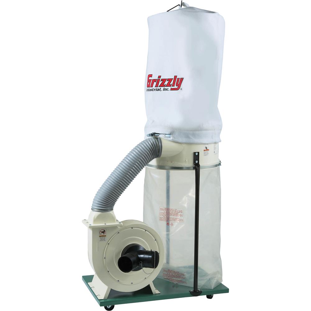

Im looking at upgrading my dust collection. I currently use a shop vac w/ a dust deputy but it fills up so damn fast and also doesnt get a lot of the good good from he bigger machines.
So my options that I'm looking at are:
  1. a USED 2019 MFG Powermatic PM1900TX-CK3
    1. https://www.ohiopowertool.com/brand...lters-and-dust-collection/powermatic-1792071k
    2. 3HP biggggg CFM but also BIG unit
    3. ~ $950
It's a 3 phase unit which means I need to grab a VFD Single phase to Three Phase converter for like $200
Orrrrrrrr
2. A Grizzly G1029Z2P 2 HP Dust Collector with Aluminum Impeller - Polar Bear Series
Single phase so no converter needed.
$679
The shop is 24x27 10ft ceilings.
Thoughts?

I have an older version of the Grizzly. Works well. The 3ph is simpler, no capacitors or centrifugal switch in the motor to fail, but offset that with the converter complexity.
Mine does what I need so I'd have a hard time justifying the added cost.

I am having a problem with the specs on the Powermatic. for instance it looks identical to this Grizzly,
https://www.grizzly.com/products/shop-fox-3-hp-dust-collector/w1687
Which has crazy specs on air flow. The 2HP Grizzly I suspect the specs are a bit inflated too.
Myself, If I have to buy one, IMO the Powermatic is twice the unit compared to the 2 HP Grizzly. More HP, more filtration area. Potential to run it off more machines at one time. The downside if do you have the room for it?
That 2 HP Grizzly is a one or two machine collector. If you want to run a bunch of permanent duct the Powermatic will blow, (****?) it away.
I have the Harbor Freight one similar to the 2 HP Grizzly, but 1-1/2 HP and it is a one machine at a time collector. I suspect the Grizz is a bit better than mine.
Yeah Im sick of tripping over the 4" hose and having to move it between each machine over and over again. Im looking to do some permanent fixing.
I was actually looking at the single phase https://www.grizzly.com/products/gr...h-aluminum-impeller-polar-bear-series/g0562zp as an alternative to the used powermatic. Grizzly has like 50 different dust collectors on their website for all different prices. Its cray cray.
What equipment will you tie in?
What is your DC piping like? Where are your valves?
I have:
  • A run of the mill DW745 table saw thats built into an outfeed table.
  • 13" Planer
  • 8" Jointer
  • 12" Miter Saw
  • Router table
  • Anddddddddddddd all the small tools I figure I'll keep using the Dust deputy + Shop vac on wheels.
As for piping. Im just using a 4" expandable from rockler that connects to the various tools. The table saw has about 8ft of 2" hose permanetly fixed under the table that converst to a 4" quick connect though I'm fairly confident no dust gets sucked up from that table saw lol.

And that would be best practices, yes. And no matter the system, yes you should wear a respirator, not a mask.
And to much of any fine particles in your lungs will eventually harm your health or even kill you, yes. That is proven by observation going back into the 1850's when occupational health started. Coal miners, grain elevator workers, mill workers, plating polishers, and yes woodworkers have all proven this with their lives.
So that being said, Can you not eject dust outside?. If not, you have listed two chip collectors with canister filters, they are 100's time better than the slightly cheaper model with just the cloth back filters and have better cfm to boot as the bag style clog fast. Get the larger 3 hp model so you can actually put a cyclone on it and your system might not be "best practice" but its certainly going to perform well and in conjunction with a respirator its going to be safe.

Problem with the HF is the lack of HP. Like a lot of Big box store items with electric motor last they lie about the HP. They state it’s a 20 amp motor and by the laws of physics, if it was an efficient design it could only put out 1.5hp and I doubt it’s even that efficient and some are running them ok on 15 amp circuits. Look up a single phase full load amp table if you don’t believe me.
I will still work ok as a chip collector but it doesn’t have enough cfm due to lack of HP (their cfm numbers and micron ratings are an utter lie as well) but fine dust will escape.
The “best” standard is to have 5 hp with a cyclone to have enough cfm to ensure all most all dust is caught even with the decrease of cfm with the cyclone. That is why I recommended the 3 hp model (that’s a truthful rating) as while it’s not “best“ standards it gets in the “pretty good” range of collecting fine dust and definitely has over twice the hp as the HF model.
Also note, most of the grizzly dust collectors have aluminum impellers. You don't want that. A small chunk of wood(or god forbid a coin/something metal) gets sucked up it can fracture the blades and ruin/unbalance the impeller. This is not an issue (other than the noise) with a steel impeller.

I have a 2 hp Reliant, runs on 220, modified with a homemade cyclone and a pair of huge Wynn filters. It's fed by 4" PVC, with valves at the different machines. Other than only being able to use one machine at a time, it's dandy. Honestly, if you can use two machines at once, you've got other problems.
At the NWA, we've got a 5hp Clear Vue CV1800. It's dandy, too, but not a whole lot more effective than my 2hp. You can run 2 or 3 machines at once with it, but then there's enough bodies to pull that off.
We also have a couple of the 110 HF units. They've gotta be right up close to be effective. Any length of hose and they're screwed.
Oh, about hose. The less the better. You want hard, smooth piping all the way, then minimal hose to the machine. The reason is that the corrugations create turbulence, and effectively reduce the diameter of the hose. The deeper the corrugations, the smaller your hose becomes. One of those 4" nifty clicky, stays in place, corrugated hoses has an effective diameter of under 2", due to turbulence. The better clear **** with the wire in it, is a little better, maybe just over 2". For the time you must have hose, they do make more rigid 4" hose that has an effectively smooth inside. It's what I use with large smooth rigid elbows, to keep the wind moving.
If you insist on long runs of heavily corrugated hose, then you'll need the 3 or 5hp machine to keep up.
And filters. Forget the bag. They beyond ****. You want to slow down the air velocity to a crawl. So particles stick and don't get forced through your media by high velocity. Surface area does that. The kind you get with 400 sqft of filter paper accordioned up into a giant air filter or two.
