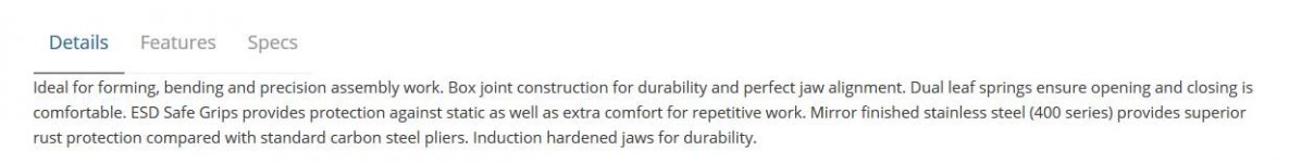

I'm liking these Aven Technix 10307 chain nose pliers Home Depot Page
They are stainless steel with a box joint.
edit: Aven Technix 10301 seem identical but without jaw serrations. They can be had for $11 at amazon. Amazon page.

If you broke those Craftsman, then you are looking for something stronger than precision pliers. When I think of precision pliers, I think of delicate work that wouldn't cause a break. Tronix are nice but I think they are best suited for delicate work. I think the Klein and Knipex pliers in the OP would probably be okay for your use. You might want to step up a size if you want something stronger than the Craftsman. I personally wouldn't buy the Aven--they are made cheaply in Pakistan.
