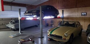

No one has mentioned WildFire Lifts. They seem to have a different design for lifting. A boxed section over the posts. I don't believe I have seen this design on any other lift I have viewed.
RaceCougar, does that Cougar have a hopped up 4 cylinder with a turbo in it? Looks fast.
:ROFLMAO: Hi Duane.
Something to keep in mind with the boxed column design is the lack of adjustable lock ladders. You're either stuck with the slope of your floor, or you're shimming posts to get the runways level. The lifting cables will be outside the columns as well.

I have 2 Bend Pak HD-9 lifts that have been up & in use for almost 20 years. I actually can't compare them to others because I've never used or had another one but these work well. I have heard that since I purchased mine that they are not made in the USA anymore & that the casters don't roll that great. I've never had any trouble moving mine so the caster design may have changed. I don't have floor drains but my floor is pitched forward & has a 2 in drop over the 24' depth of the garage. I never shimmed or felt the need to shim them.

I have 2 Bend Pak HD-9 lifts that have been up & in use for almost 20 years... I don't have floor drains but my floor is pitched forward & has a 2 in drop over the 24' depth of the garage. I never shimmed or felt the need to shim them.
There's no reason to shim a lift that has adjustable lock ladders.

I don't know what "adjustable lock ladders" are but I am positive that my lifts don't have them.
They are rails inside the columns that can go up or down to adjust the lock point. They are meant to adjust the lift so all corners lock at the same time.
They are also amazingly handy if you have a car that is 1" taller than the ideal lock point but don't have room to use the next lock point. You can just raise the existing lock point and squeeze your car in.

Point of preference. For me, I absolutely want my runways level on the locks, and shims can be a pain to deal with if you move the lift around regularly. They can also require longer ramps to get lowered vehicles on/off the lift (there are a few threads on this site covering that topic). But yes, plenty of folks deal with it.
Maybe the old HD-9 doesn't have it, but the current HD-9 does. Searching Google, I can't find a photo of a HD-9 (even the older blue ones) that doesn't have them. A pic or two of your columns would say for certain.

That's a great idea. Mine are the permanent, rectangular blocks welded inside each post.
