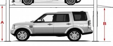

Hey all, I'm hoping you can provide some real-life data points here.
I've got a 99 Land Cruiser on big tires that's around 76-77" tall with the roof rack. I want a lift to store my lowered Supra on top of it. According to the BendPak literature I'll be fine, but only with a couple inches to spare. I plan on daily driving the Land Cruiser and parking it regularly under the lift so it's imperative that it actually fit.
Can anyone provide the actual drive under clearance at the top one or two rungs in their BendPak or other 4 post lift? Dimension "B" in the attached pic.
I know the approach ramps generally dangle so I'm planning on taking them off or having to re-engineer something for that aspect. I'm more concerned about the clearance under the main ramps or any other permanent part of the structure.
I'm looking at the HD7 and HD9 series. It'll be a very tight fit.
Thanks!

The hd-7pxn (narrow) or hd-7pxw(wide) are the tall ones and have 140" clearance under the lift platform (Max)
The regular lifts are the 80~ inches of clearence

I would consider those, but that's an extra $3k on top of the non-RV oriented lifts. Before I consider dropping that much for about 60" of extra clearance I don't need I want to see exactly how close I'd be with their more... "normal" 4 post lifts.
But touche, the super high rise ones are an option.

I'm completely with you on most all of this. I planned to get a Roof Top Tent and some serious roof rack accessories (Kayak, awning, hi-lift mount, etc..) and have a nice ceiling mounted hoist to hold the RTT when not in use and on and on. But then... we bought a house with a fantastic garage space minus one thing: The 7' garage door. No matter what I do for the lift, I'll have a 83.5" hard limit on clearance from the doorway. I'm not going to pony up to remodel the front of the house with a bigger door so that's just the way it'll be for the foreseeable future. I'd add on a third bay with a 10' door before I re-framed the existing garage entrance. As is, I can't have anything on the roof of the Cruiser. I've long given up that dream in favor of an even better one: An expedition trailer. We have storage on the side of the house with an enclosed gate that would be a perfect home for a dedicated off road trailer. Making lemonade from lemons!
So that being said, I don't see the lift clearance being a problem from the standpoint of forgetting anything on the Cruiser roof. I already know not to have anything up there. 'Tis a shame, but oh well.
I had the exact thought with the steel plates. I could have some plates waterjet or plasma cut just bigger than the lift feet and mount it just like you said. That's more or less my back up plan right now in case I need an extra inch or so. Bendpak states a max 1/2" shim with their provided shims, but I'm sure you could safely increase that allowable extra lift with some custom plates like we're talking here.

Now if you still want to, for a few extra inches consider mounting the lift on some 2" thick steel plates. I would make the plates larger than the feet, bolting the plates down to the concrete and threading the plates to take bolts from the lift itself. Maybe have to use a 2x6 runners to get the supra on the runway.
Good and affordable idea here. I'd also setup some sort of height alarm to trip when a vehicle taller than permitted were trying to get under it.
