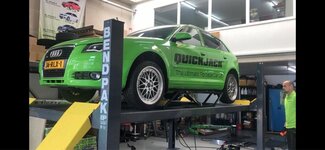

Here is a better option that may be cheaper if you can find it on sale.
I know Costco had the on sale $1199.
I am considering this option for my BendPak four post.

I have a manual jack and have absolutely no problem with it....no effort at all to crank it up. I imagine the jack itself is the same except one has a manually operated cylinder and the other air operated. Unless you have a shop where the air compressor is always on whenever you are there, it is a pain to have to pressure up a compressor just because you want to use your bridge jack. Plus, no air lines or hoses to get in your way.

That is a fascinating idea. If anyone has done this, please chime in.

You can buy 4 HF aluminum $59 jacks and do the same thing. Or buy a jack tray and jack and use jack stands.

Same here - I have a pair of Direct Lift manual bridge jacks. If I was a production shop, it would probably make a difference, but not for a home garage. In fact, I think once in awhile a manual jack can actually be an advantage when you're trying to position something (e.g. lining up holes) and need a slow, precise lift.
